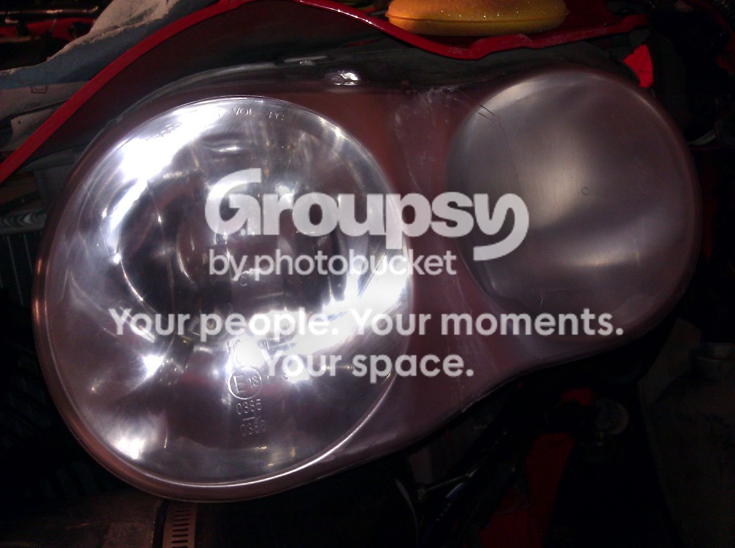

So, while I'm waiting for the new starter, I decided to try and clean up the headlamps. They're yellowed, hazy, and pitted. Can't even see the bulbs inside.
Started sanding with 600, then 1200, then waxed. Still just a little hazy, so I'm gonna go back over it with more sanding, some 2000, and then wax it better. Then do the others. As it is, it's still lightyears better than what it was.

for the final buff use some toothpaste and an absorber helps a bunch.
