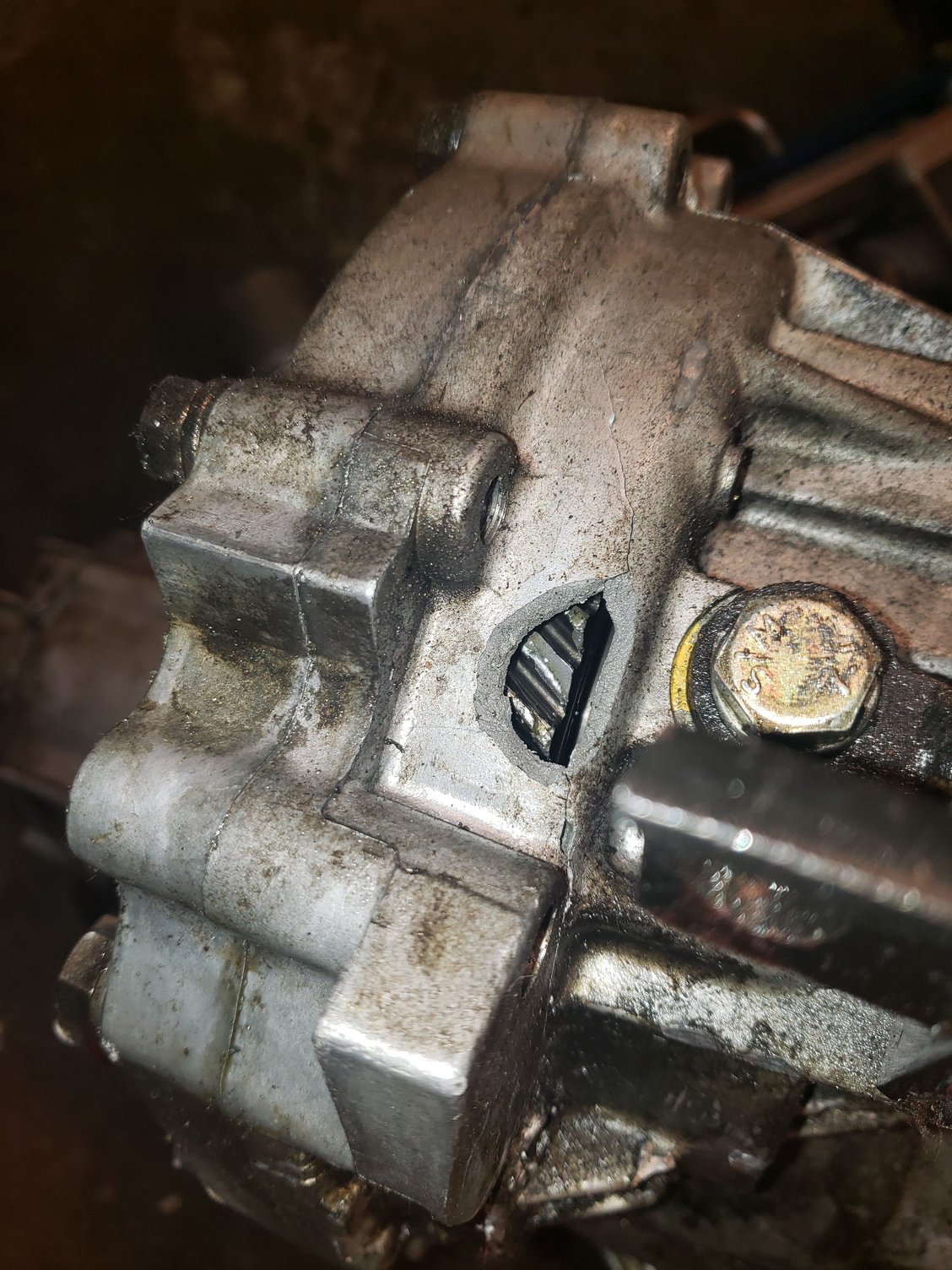

.... I found a six speed beta transaxle online, and called Korea about 16 months ago. The guy could speak English and said he was standing over a 6 speed right then. $975 he quoted me. And I have no idea what it would of cost to get here to USA. They are supposed to be really tough though. I just did this to me Tiburon (lower geared 'wide ratio) transaxle (see pics)
That is the input shaft in the pic. This crack is under the bell housing with the clutch
Stripped teeth off the ring gear visible through the hole blown out of the case.
At the race track with drag tires.
