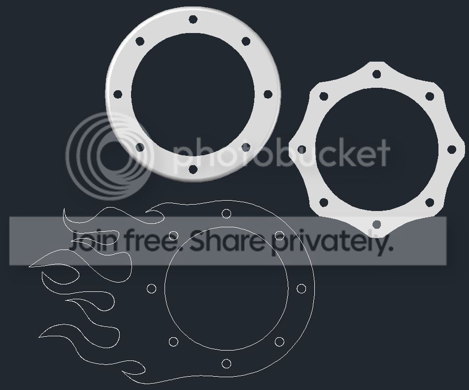

Something else I'm working on, although not a priority, is a trim ring for the exhaust pipe.
I've come up with 3 pretty basic designs. Shouldn't cost me much to send the file to CNC.
And then the most badass one ever! lol
