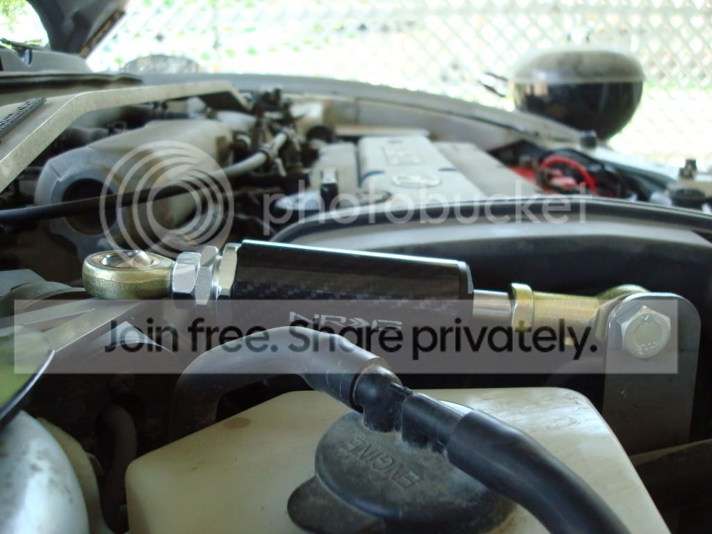

showing what i know so far...

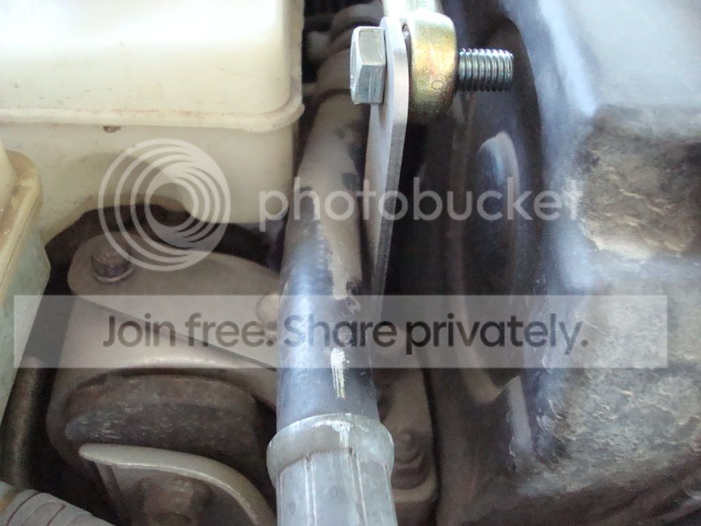

welp, cruise control is in the way. my power steering hose rubs on the front mount. I can turn the hose out of the way, but then the stop pads on the hose connector and the power steering unit will not hit, i don't like that.

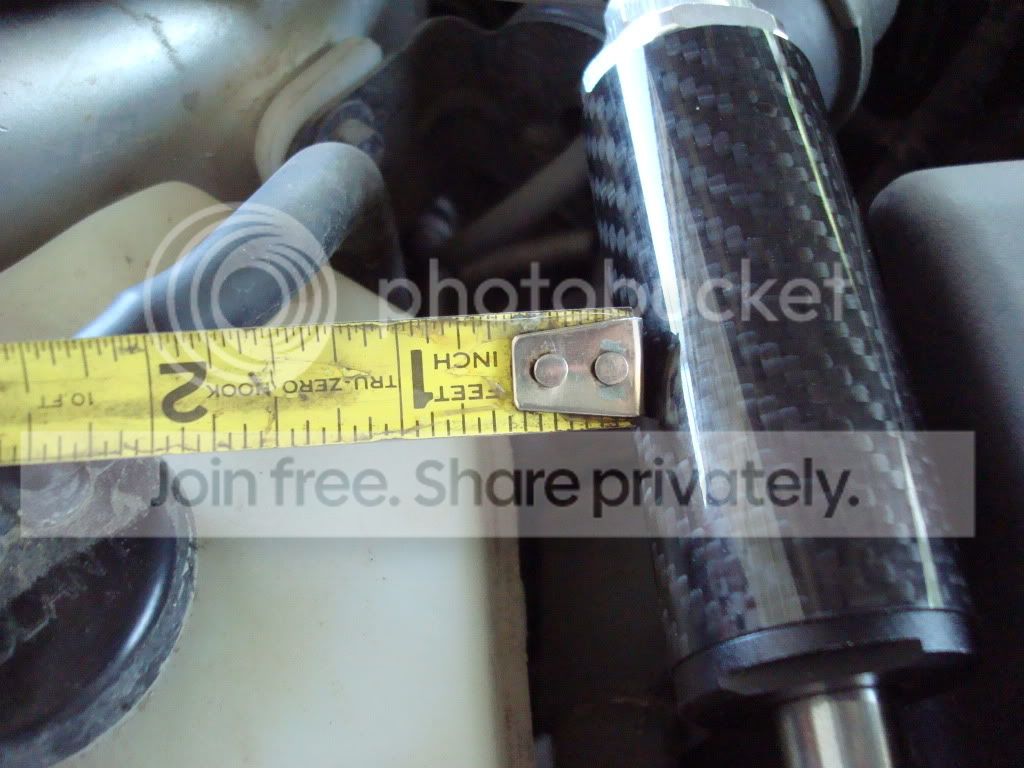

we do have roughly 3/4" of a inch of space from the coolant overflow tank. what I am thinking is I can use that room, get it to within 1/4" of the overflow tank. If I can go that far, I will make sure that we can get a 13mm craftsman socket on the farthest inside bolt on the bottom mount. this we'll give hopefully 1/2" more clearance for everyone that was worried about the timing belt.
bringing in the front mount 1/2" closer to the overflow tank I will also have to redo the strut mount to slide that bolt hole over also. doing this will also make us have plenty of room for the cruise control. if we still have problems with the cruise, a adaptor plate will be needed to slide the cruise control module furthur back towards the firewall. not a big deal really, just a single piece of say 10 gauge with four holes in it to move it back 1/2".

My power steering hose had been moved to the side for years now, with how much I take my timing belt cover off.

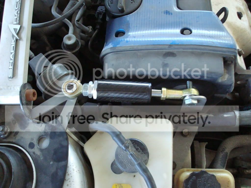

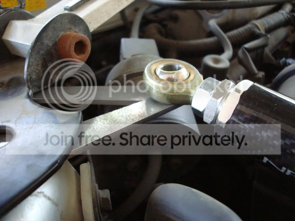

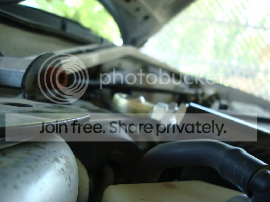

pics of the problems we are facing so far...
I will get at least the strut mount done tonight.
I know the cylinder is not supposed to be mounted on top of the strut mount, but can't get it bolted on right now cause of cruise.
One thing, the engine mount side, put the strut on the OTHER side, or if not that, put the bolt through the other way. Gives you much more room.
kk, the pics as of right now were mockups. REDZ, would NRG go with nylon locking nuts or is that something we would have to change on our own?
