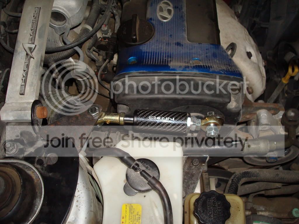

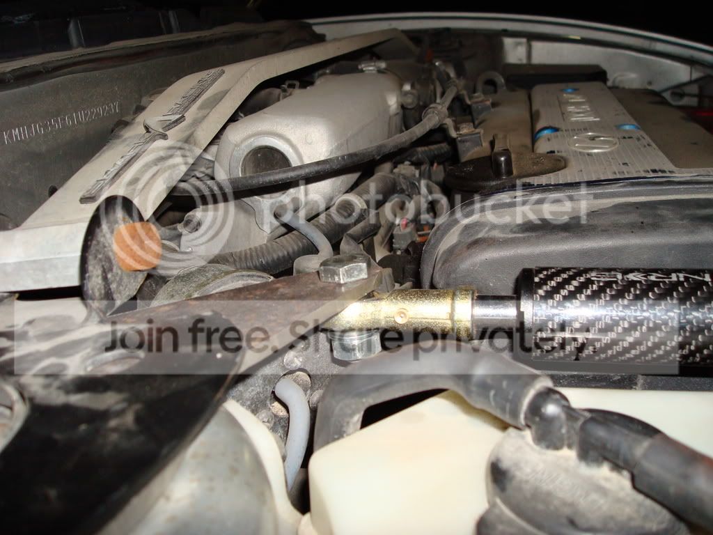

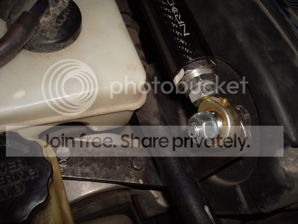

bolt holes moved 1/2" forward per request
old front bracket rubbed the P.S.hose on the upright part, not anymore!
plenty of room now for the cruise control.

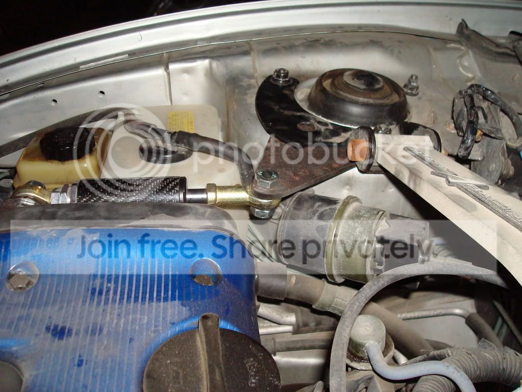

view of top mount from the side of car.

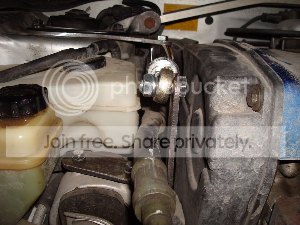

front mount showing all OEM placement used.
