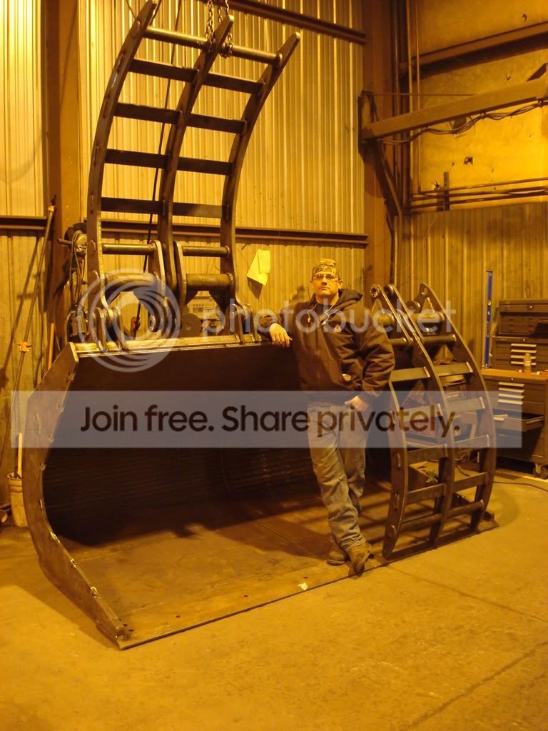

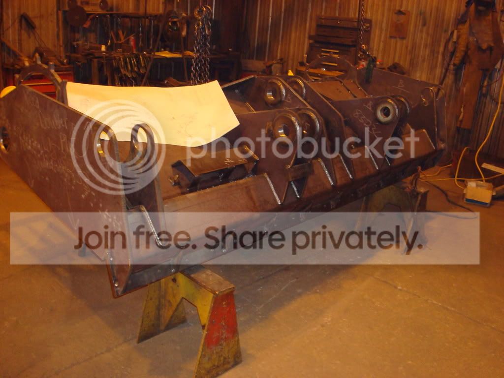

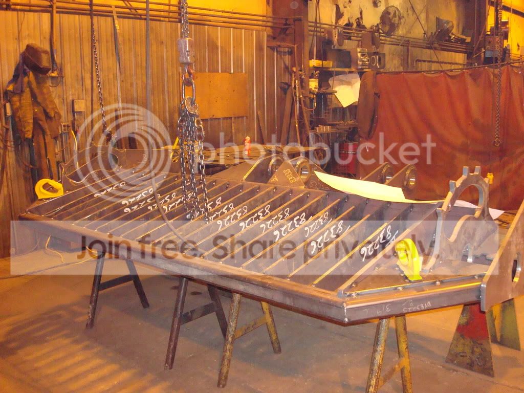

it doesn't need a gusset since it is a side pull opposite to the force being applied to the gusset. getting the best angle to where the cylinder does the work is the key on this. I work with gussets and other forms of reinforcement on a daily basis with the buckets and blades I build where I work.
this is totally off topic but just to give you a idea of what i build, here is some pics.
5 cu.yd. forestry bucket w/detachable sideplates and grapple arms
backside of HD multi purpose bucket
top/front side of HD multi purpose bucket
once again, sorry for the OT.
