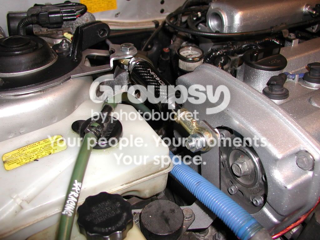

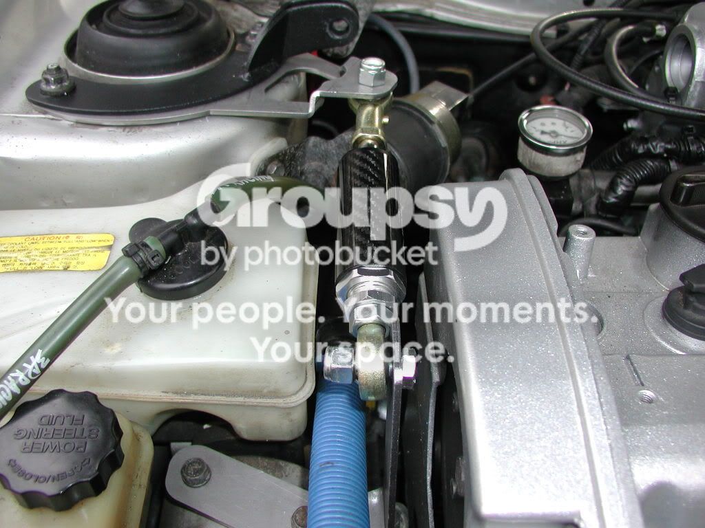

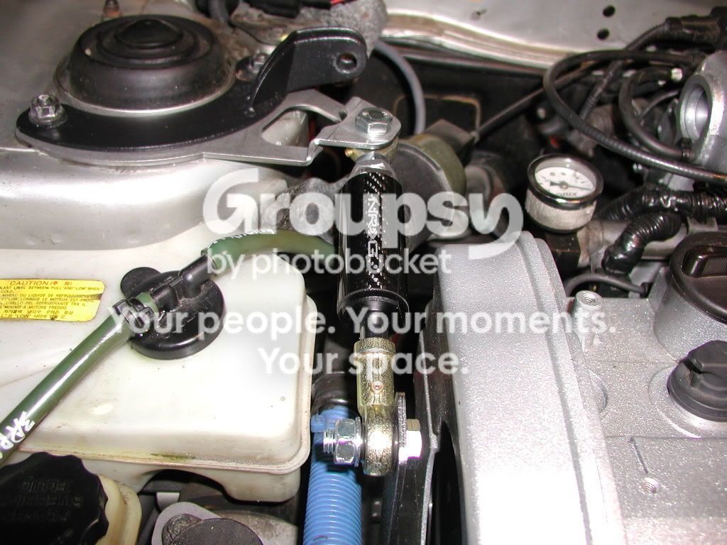

BTW, if you guys LOOK at the last pics I put up, you'll see the current plate works fine with a strut bar.

I thought I had posted the last set in here of the current brackets, but I guess I posted them elsewhere. Someone can look through my photobucket for them if they want, should be easy enough.
I'll see what I can find.
Here it is..

that top bracket was exactly what i had in my mind. I saw those pics one time but i guess not on the site. must've been whoring around on your photobucket page. cool.gif
tell you what, i'll make one of both, we'll see what everyone wants in terms of two holes or three. we might as well since we are the people that are going to be using them, haha.
still trying to figure out that bottom bracket in my head and be able to make it out of one piece than having to tig weld something together.
I like the bent version of the top bracket better than the fourth pic, that just looks weak IMO.
