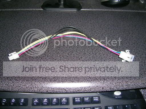

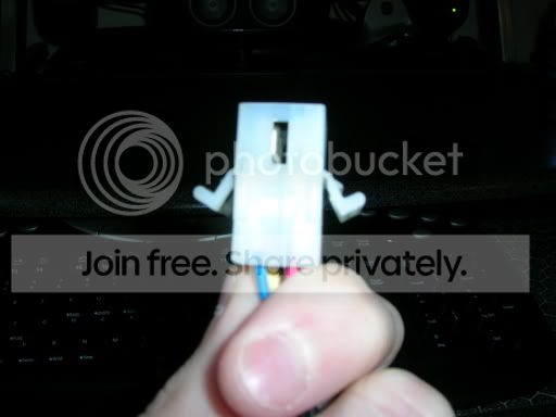

yeah that c134 is tiny. fitting any psu in there has got to be hard. i also made a home brew power cable. the opus 120w. has a 6 wire connector, so it has a bit more to it. 2 grounds, 2 constants, 1 ign. turn on, and 1 accesory turn on(remote turn on lead for amp). im also making a panel mount for my gps antenna-->oem reciever, which will be in my case. using sma connectors for that. im going to use the panel power&ground mount that came with the case for the cases's psu to power my lilliput.
anywho, here is the opus to panel part of my power cable. the left side is the connector for the opus, and the right side is the female part of a panel mount molex kit(or whatever they want to call it) i bought from radioshack:
did you ever consider mounting the psu to the top of the case? still probably not enough room for one of the bigger opus psus, but may open up some possibilities. the opus 150w is acutally pretty small
