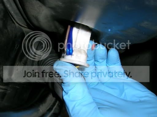

picture to kind of further clarify how I ran wire through the stock door grommets.

I still don't get how you got that thing off mang.
DIY TIME!

yeah redz, i have a spoiler. stock rd2 right now. to get that clip out you have to use like two little screwdrivers and get at it both from the inside and outside. you can unclip 3 from the outside, but you need to unclip the last one that the edge of the door is blocking with a long screwdriver from the inside. take the that little boot off, and you will see 4 clips on it holding it in.
