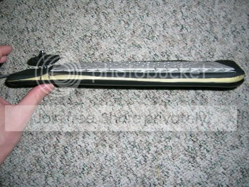

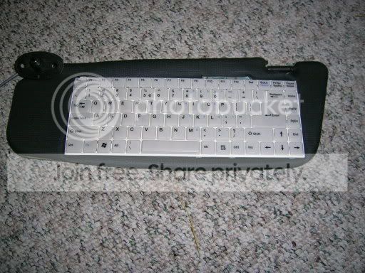

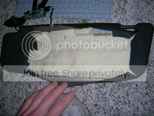

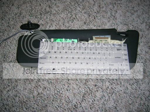

keep in mind, i had my fenders off, which is almost a must in getting those connectors unclipped from the door jam. i looked at it a couple days ago, because there is a break somewhere in the circuit from my driver side window to my pass. side. i cant roll up the pass. side with the driver side control. there is almost no way to do it without the fenders off.
ill keep an eye out for that keyboard. im having a hell of a time getting the zippy without the frame in the visor. ive already had to cut the structural metal rods running through it to hell, and its super flimsy. it looks like that one is smaller length and width wise, but a bunch thicker. ill just have to see how this ends up, im pretty close to being done.
there is zero access to my alarm modules(alarm and remote start) for a crook. with the crash pad off, i wedged them in between the firewall and the main interior wiring harness, from the top. they are really secure, and fit like a glove. it was also a very short route to everything i needed to get to as far as ignition and that stuff goes. my window modules are stuck on the right side of the blower motor plastic casing, and my two fuse blocks are stuck in the steering column support spaces. about 5 extra relays are just ziptied up to keep them from falling down into my feet. i even had to use relays so that when i roll up and down my windows with my alarm remote, it doesnt set off the motion sensor. that was a PITA, because the sunroof is included in that equation. i ended up using the lower power relays out of the factory keyless entry module, becuase i didnt want to use big, expensive bosch relays to bypass a sensor trigger. which ended up being another pita alltogether because they are pcb mount relays.
the mirror is really bad-ass, but it seems it needs to be a little stiffer. 15 minutes in my coiloverd tib and it starts to ease its way down. i think it would do it in a car with factory suspension too. kind of annoying because everything else with it works so great.
and hkc, keep reading and learning and you will figure things out. i do everything far from right, i had the dash off just the weekend to fix a couple mistakes from the previous 6month hiatus, and im still not completely done.
heres some pics of the keyboard in visor progress...
