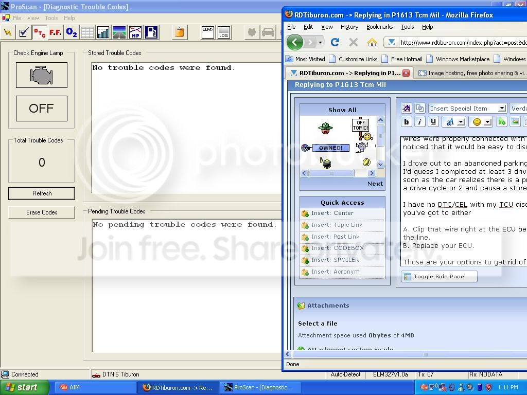

I just finished up swapping my rear speakers. While I was doing that, I verified continuity from the back of the stereo deck to the rear speakers to make sure the wires were properly connected with correct polarity. While I was doing that, I noticed that it would be easy to disconnect the TCU plug.
I drove out to an abandoned parking lot to crank my music up and then to the store, I'd guess I completed at least 3 drive cycles. Now, Pending codes will pop up as soon as the car realizes there is a problem. Pending codes will activate the CEL after a drive cycle or 2 and cause a stored displayed trouble code.
I have no DTC/CEL with my TCU disconnected. This would suggest to me that you've got to either
A. Clip that wire right at the ECU because it's shorted to voltage somewhere along the line.
B. Replace your ECU.
Those are your options to get rid of that flippin' CEL mang.
The car drove fine with no noticeable problems or even a change in the driving performance, with the exception of cruise control did not work. I just hooked it back up to re-enable my cruise control after taking that snapshot. It's my belief that the TCU in a manual transmission Tib is for cruise control only. If the torque reduction signal was used, then the car would have driven differently, I think.
