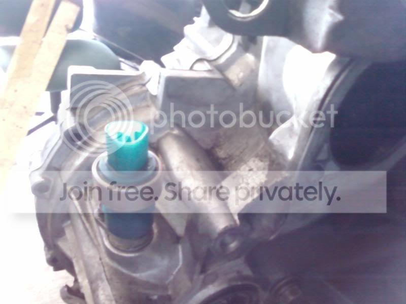

No brackets, went to the junkyard and found two rd1s, one of which was on top of two other crushed vehicles. Found my correct speed sensor among a few other things, the guy working the desk let me have it all for free, since he apparently saw my acrobatics to get up and around there.
Put in some work on the car, painted a few things here and there, finished cleaning the engine bay.
My new sensor:

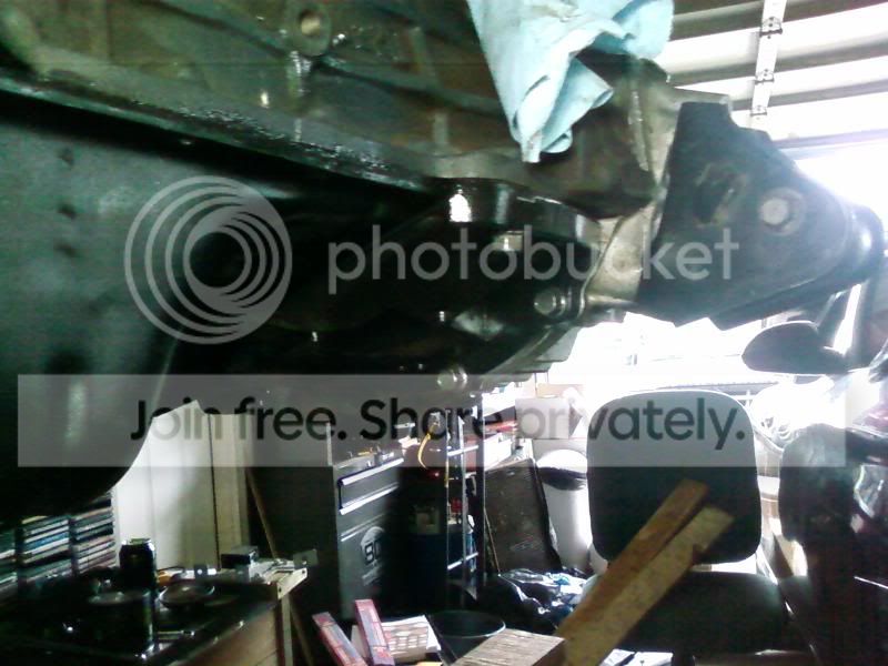

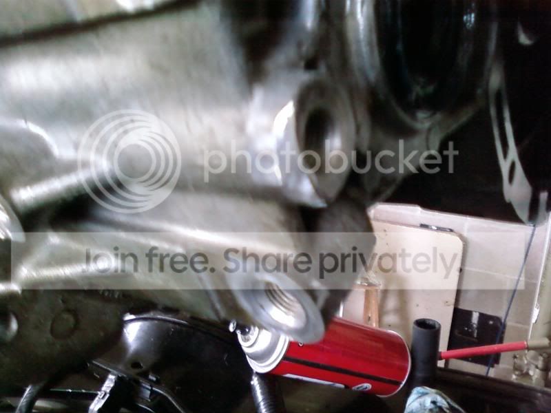

Ground down the corner of the beta 2 tranny:

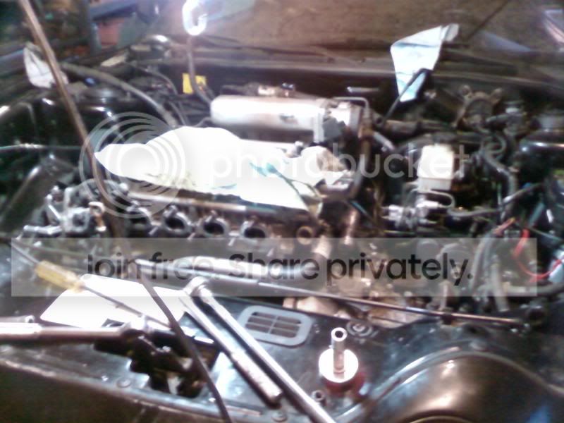

Got everything bolted on and ready to drop in, can you guess which pieces I painted? Yeah.
And bam, it was bolted in!

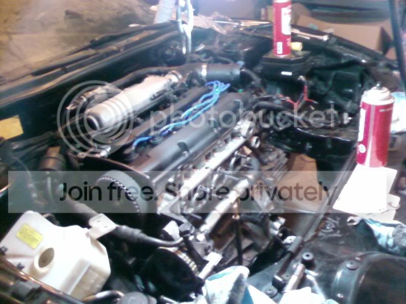

I went really slow on the install, making sure I had everything hooked up right, making sure the wires were secure and out of sight, here's where we stood at about 5:30 saturday night/sunday morning:

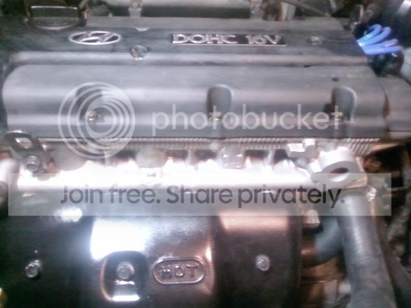

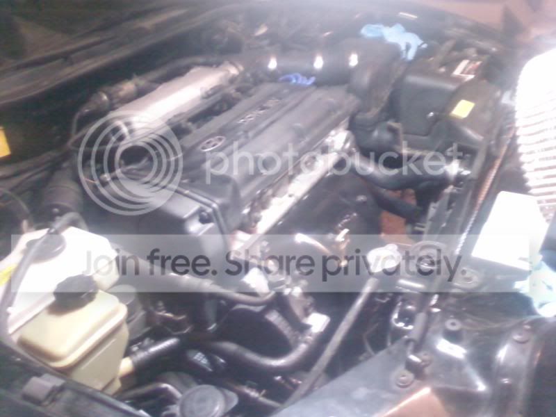

Worked 10 to 5, my last day on the job. Went and got the misc. hardware I needed afterwards. Didn't get started on the car till almost eight, worked till about 2AM, but I got it started for the first time! Here's how it looked monday night:
A great shot of my nicely painted heatshield:
