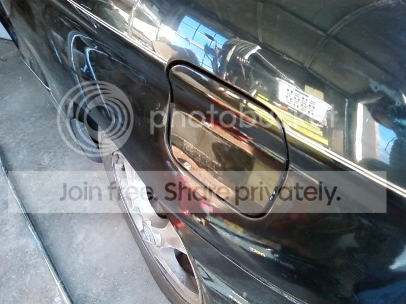

First off, got that damn fuel door replaced.

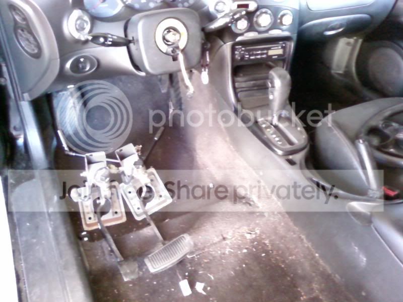

Also, I discovered that installing the pedals is a lot easier if you remove the seat and steering wheel fing02.gif
Sadly, the nice condition steering wheel that came from tibbychick doesn't fit, apparently there's a difference between a 1998(I think?) and an 01 wheels. Ah well, I'll sell it I guess. Today I got the new brake pedal installed and the holes drilled for the clutch pedal, I need to enlarge the center hole and then we're golden, not too bad for a few hours work.

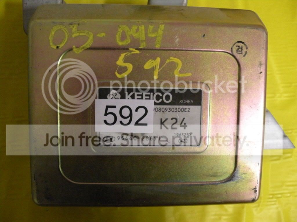

Now it's question time. The computer I removed from the future home of my clutch pedal, landshark referred to it as the TCU in his DIY, but really, wtf is it and why is it there? I'm guessing it's the transmission computer for the auto that I hopefully don't need anymore and can throw away *crosses fingers*
Old Mar 31, 2009 | 09:20 PM
TCU is behind the radio, almost under the airbag. You threw away your ECU. Your car needs a TCU on a manual tranny for cruise control

I haven't thrown it away yet, I'm just trying to figure out if I need it, and secondly where to put it once the clutch pedal takes up that space...

You can put it anywhere you want if you extend the wiring. Lol find a place you want to hide it and tell me how much of an extension you need and I'll make you one, it would be about $175 though lol, it's hard work.
Doubt you want to spend that uch on an extension but it is in essence a plug and play harness, meaning when you want to get a piggy back you take that plug to your desk and attach the piggy back instead of upside down in the driver side foot well lol.

Well where its this computer mounted in a factory equipped manual car? Are the wiring harnesses different or longer? This may be a better solution than cutting and soldering two dozen or so wires. I mean, I've done wiring harnesses before, but I'd rather not do it again if I can avoid it.

The ecu is in the same spot on both cars. It's just really close to the clutch pedal in a 5spd.
It's the same in both my auo and my 5spd tibs. I just finished making my plug and play harness and installed it on my tib. The reason it is so expesive is you buy a junk ecu and take the plugs apart and solder each pin respectively. It is time consuming and you must be very carefull not to wreck a pin while doing it.
It should be fine in the stock position.
by the way, we are talking about this right:
And not this:
First pic is an ecu from a tiburon, 2nd pic is a transmission contorl unit from an elantra(same).
