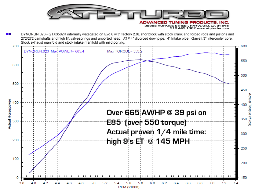

So if/when I decide to upgrade the turbo, I think I'm going to go with a manifold similar to (if not the same as) this one:
http://www.full-race.com/store/turbo...-radiator.html
Here is a thread that I started years ago:
https://www.hyundaiaftermarket.org/f...-similarities/
It appears the ports pretty much line up perfectly. If all that is required is some modification to the mounting holes that is gravy. I'll be on my way to having one of the highest quality exhaust manifolds that is available.
Here is the turbo I'm interested in:
http://www.atpturbo.com/mm5/merchant...de=GRT-TBO-102
With this exhaust housing:
http://www.atpturbo.com/mm5/merchant...de=ATP-HSG-009
Should be good for at least 650whp and still offer decent spool time according to this dyno graph:
http://www.atpturbo.com/mm5/graphics...-VEVO-107A.gif
What does everyone think?

If you can weld, why not build your own manifold? If not, then I would look around to having someone locally build you one. They should be able to make you something for less. Although, the main reason is that you want to make absolutely sure that the turbo housing will fit where that manifold locates it. My 60-1 sits very close to the block and leaves little room for my radiator. I'm not saying you can't use that manifold, but I would make absolutely sure it'll work for you before making a $1400 mistake. Maybe see what their return policy is. Also, they build custom parts all the time, maybe they can adjust one for you, or leave the mounting holes out so you can drill them yourself?
Old Mar 22, 2015 | 10:30 PM
  #338
tdonnell's Avatar
Posts: 1,497
Yes I can weld, in fact I've customized and repaired the OBX manifold I'm still running many times. I've thought about making my own, it would be cheaper and I could get the perfect fitment and wastegate integration. The only issue I'll have is the flange that bolts to the head. I'll have to get one water-jet cut.
I know they make custom stuff, I was thinking of asking if they could use a flange that would have made so it will bolt right up. I was also thinking about clearances. If I go with the GTX turbo I listed, the compressor housing will be larger. My 3071 is about 1/4" from the block but around 1/2 - 3/4" from the Koyo. I'm not sure of the dimensions of the standard housing on a GTX3582, I know I can get the same compressor housing I currently have on it. I just wonder how much efficiency I would lose by going with the smaller compressor housing.
I figure it wouldn't be easy, but if I needed to I could move the radiator out some (to the front of the car) for clearance on a larger turbo.
