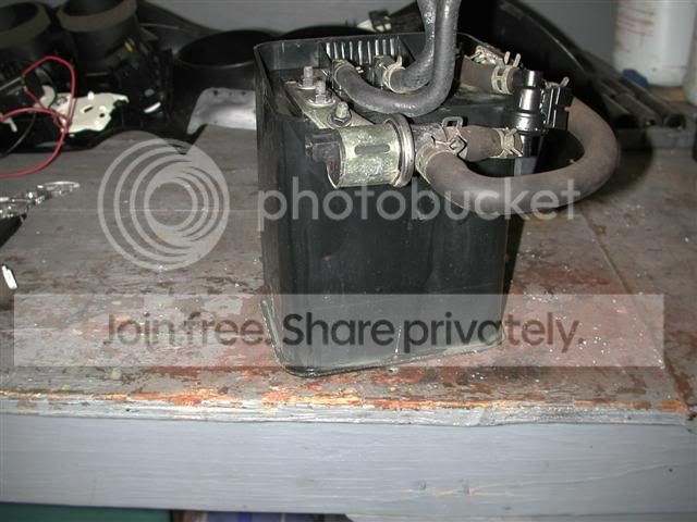

but the evaporation hose extension doesn't work... lol not much you can do from your computer but give me a pat on the back and wish me luck. maybe everything is fine but there's a leak. damnit i hate getting under there again. mad.gif
This is how the canister is:
This is how I extended it:

I just came back from a professional (i mean pro of pros) mechanic and he knew all about this, stole the words right out of my mouth. the computer decides how the solenoid functions, so extending the hoses is perfectly ok so long as all of the tubes are completely sealed and everything extended accordingly.
So i lubricated each hose with industrial strength craft adhesive (tough stuff!). Now there are no air leaks whatsoever. I know all about this now. The first nipple on the canister is for the fuel vapor that comes from the tank so no problem. The second nipple is for the purge which goes into the intake and creates pressure in the tank as well as the canister. third nipple is the air release that over certain periods of time releases leftover vapor into the open. the solenoid is there to hold pressure and release it through the other side. it doesn't constantly work, but only turns on when it needs to.

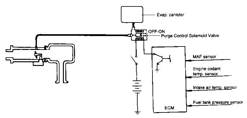

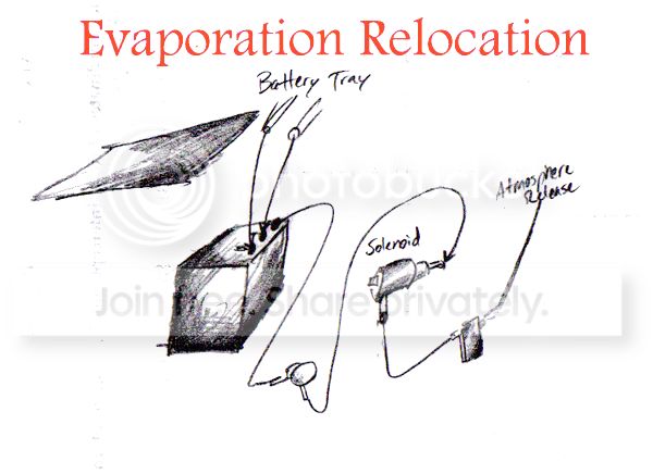

This diagram shows how it is directly connected to the fuel tank and the parts the vapor goes through:
and another perspective showing it is hooked up to a PCV:
the fuel tank line needs to be pressurized, or else the tank is not pressurized and therefore the computer will get wrong readings, and performance will be altered. It is connected to TCM, fuel tank pressure sensor and MAF sensor, that is why my gears were messing up in my Automatic, so the same goes for 5 speed.
The diagram shows Evap has nothing to do with performance my ass. if you wire everything together or just rip out the canister, you are royally 8888ed one way or another somewhere along the road.
the way i sealed it, i'd be really surprised if this sh(t shows up again. tomorrow i have to go to the exhaust shop and get the catalytic converter moved up front like it should be because i'm also getting a P0441 Catalyst below threshold. Also, the mechanic said to wait usually 3 days - 1 week of driving and the computer will do a perform cycle for the Evap system. He also told me there is an easier way of performing a drive cycle just from standing! it has to do with like I said before, entering a code; running AC, doing some other stuff... I absolutely did not know that! DTN you have helped me like nobody else on this forum.
