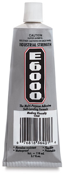

I sealed it with industrial strength adhesive all over.
I know where the leak was.
Good god that's the end of a bad horror thriller. Tiburon has a lot more power!! Drives beautifully too.

LOL, this shit holds my whole car together. i caught my dad borrowing it for his frames, and statues.
