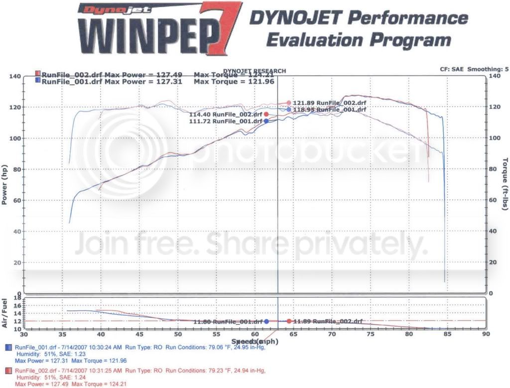

GOOD NEWS FIRST!
1. Got the Before Dyno. Not too bad...
The dyno guys have dyno'd several other Tibs before and really liked mine. They were very impressed by the consistancy of the runs, and the quality of the parts on the car.
2. Cams are installed!!!
3. Cams work great!!!
4. Car runs great!!!
5. NO CEL's!!!
Hell, it didn't even idle bad after I reset my ECU.

What mods were installed when you did the before dyno?
And so people don't get confused and think the numbers are low, what would the relation to that dyno be for a normal person not living at 1 kagillion feet above sea level? nana.gif
Are you expecting a big power increase from these cams without any tuning? What does it FEEL like?
