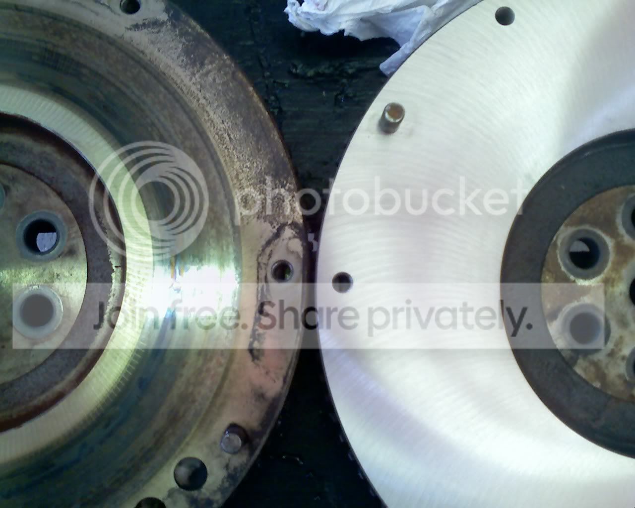

Figured I'd post a few pix. Here's a picture from left to right, Throw Out Bearing (TOB), Presure Plate, Clutch Pad, and the flywheel. Usually the flywheel would be held on the engine by 6 12pt bolts. I pulled it off so I could put on a new one.
Here's a picture of my old worn out flywheel next to my new re-machined perfect flywheel. You can make an old flywheel look like a new one by resurfacing it for about $40. The one on the right used to look like the one on the left when it came out of an elantra, now it's beautiful after a good resurfacing job.
Just so you know, that's how a glazed, slipping flywheel looks. It's been slipped by spraying nitrous one too many times.

ok, sorry to bring back such and old post, but i needed some info.
would a slipping flywheel cause the rpms to go up and not the speed, or do i just need a whole new clutch?
thanks, this will save me alot of time and money if i only need to machine the flywheel, but if not its always good to know.
Old Jun 24, 2008 | 04:51 PM
  #40
a slipping flywheel? that doesn't make much sense.. the flywheel is attached to the crank.. if its slipping, the clutch disk is worn out, you need to put a new clutch in.
it COULD possibly be a worn out pressure plate, but even IF, <span style="font-size:8pt;line-height:100%">and thats small IF</span>, you would want to replace the entire system at the same time.
<div class='quotetop'>QUOTE </div><div class='quotemain'>this will save me alot of time and money if i only need to machine the flywheel, but if not its always good to know.</div>
WRONG. it wont save you a moment of time.. to get to the flywheel, you have to take the clutch off, it would only cost more $, not take more time.
but you need to get a new clutch kit, and re-surface the flywheel at the same time.
