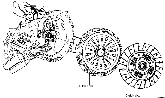

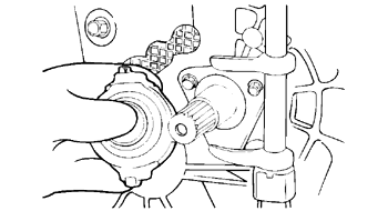

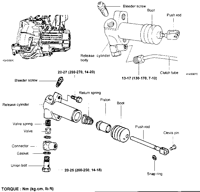

why those the fork from a 95-96 accent dose not work, they are practically the same, I have seen them both and I think it my work too bad i dont have both trannys to verify the info but here are the images from hmaservices.com
Accent 95-96
Tiburon 97-2001

accent fork lenght ,and fingers aren't the same at all
that was the first option i checked about 6 years ago..
BTW, i'll repeat it to be clear,
i've figured out the push conversion kit (fork,lever,bushings) this lets you use a NON turbo dsm clutch kit without any problems
the remaining work is to use a the larger turbo DSM (225mm) clutch kit)
