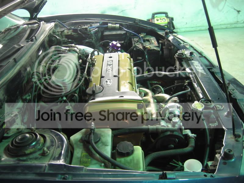

We made an intake pipe and got the car all done yesterday!

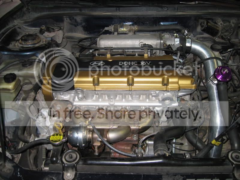

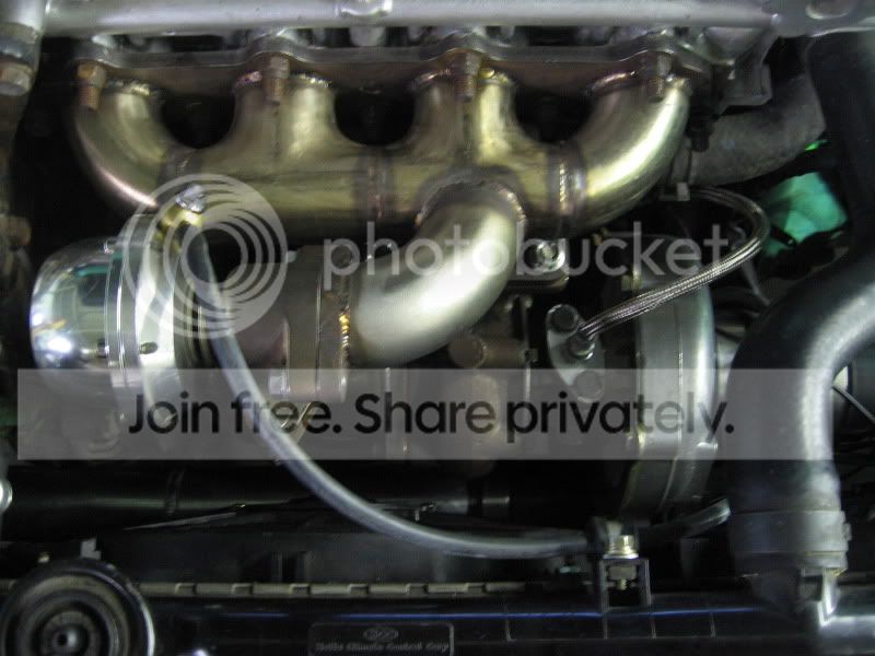

I got a few shots before i drove it home.. i need to clean up the engine bay big time so ill get nicer pics when im all done with it! But heres a few shots anyways
Everything is done but the injectors and tuning so im able to drive it without boosing it.. just making sure everything worked right before changing the injectors!

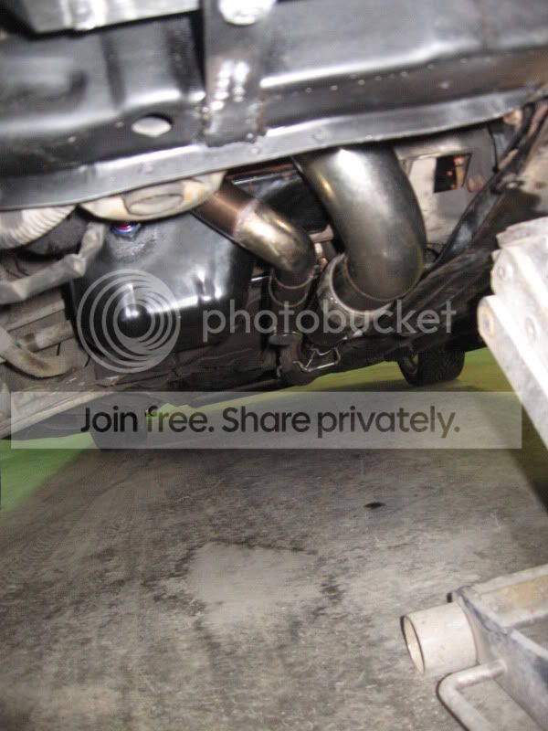

Dump tube and exhaust all done

Haha thanks! I wish i'd had my camera there when the dump tube was made.. that thing is a beast! Its like a snake u just cant see that part! Its a tight fit in there!
Ill get some vids as soon as i can boost it! the exhaust sounds super nice but i havent been able to really hear it at WOT yet!

nice job for most of the work
but i would raise the downpipe, this thing (at least from what i see on the pic) will rub way before the crossmember
Nah it doesnt hang down any farther than the exhaust... The pic is from a weird angle.. Ive only ever bottomed out the car on the front lip.. its only lowered about 1/2 an inch!
