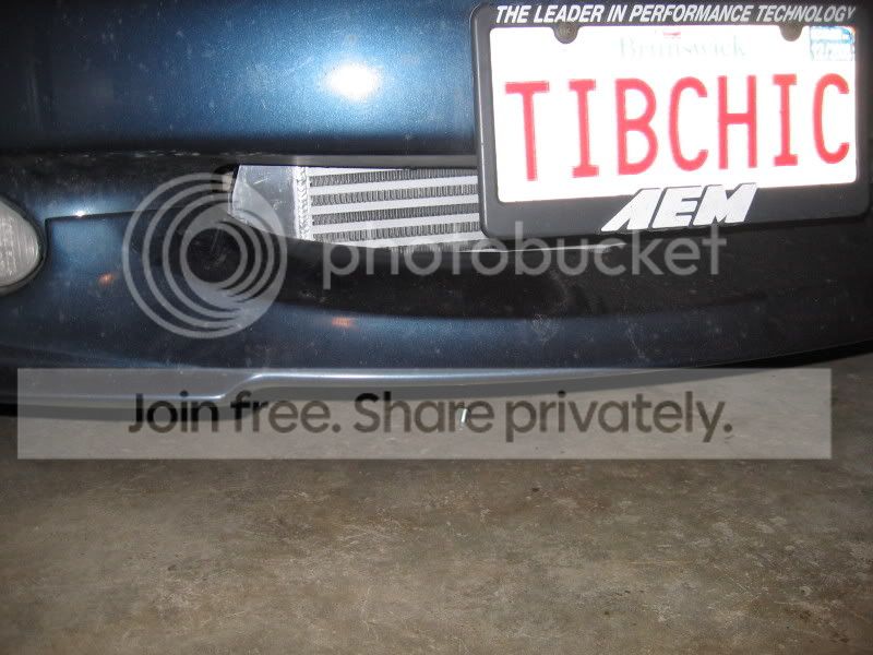

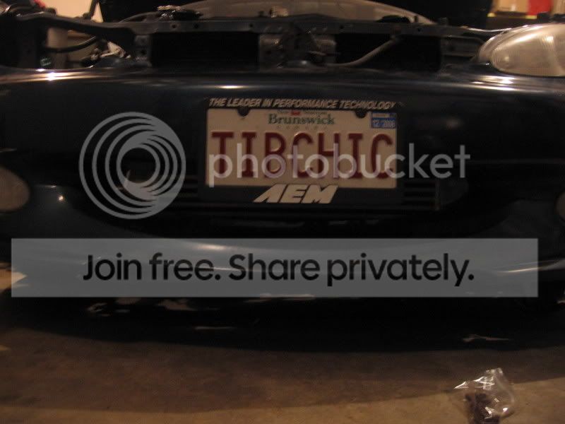

Intercooler
AEM F/IC for engine management (Installed)
T3/T4 turbo
Intercooler (installed) piping and BOV

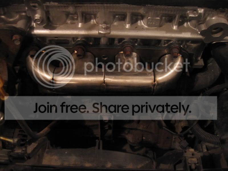

Turbo manifold (Friend is doing the welding/fabrication) its tacked together right now

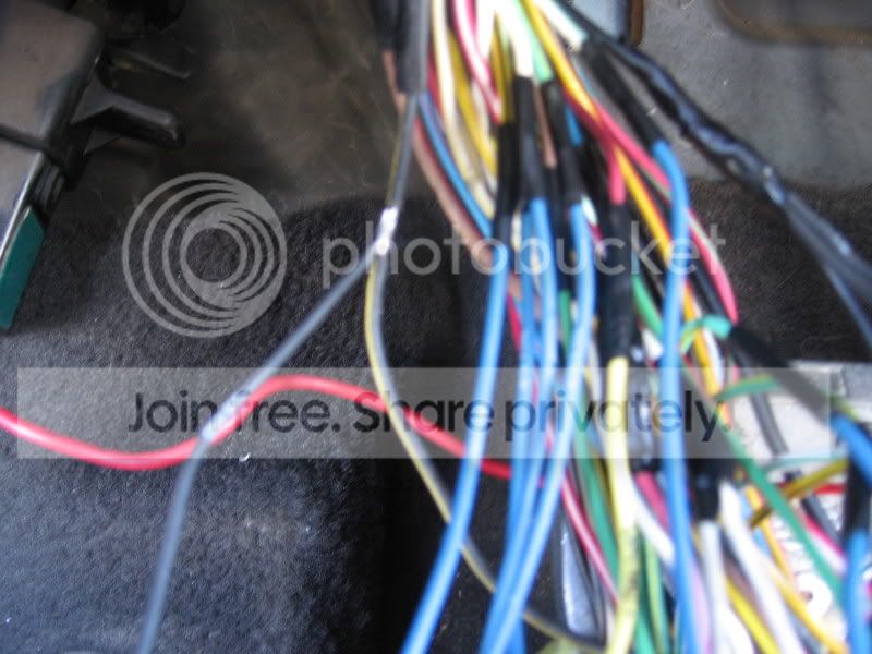

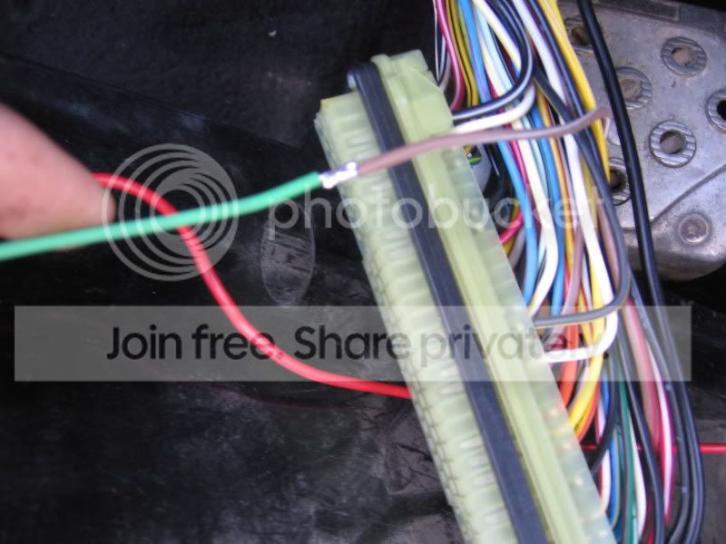

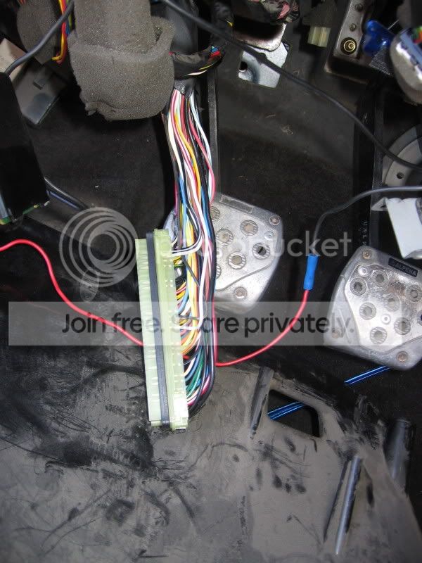

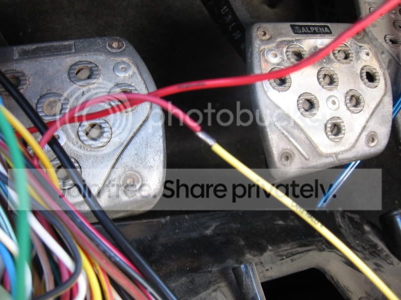

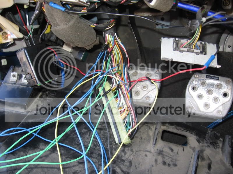

AEM FIC INSTALL
I followed instructions i found in a thread in this section, along side the actual AEM instructions and everything went great!! The colors on the diagram that i got didnt match any of my wires but all the signals matched the right pins.
Hardest part was getting the ECU out and taken apart, other then that im pretty small and was able to sit pretty confortably in the front (with the seat taken out) and do the soldering.( which is what i do for a living).
A few pics!
Gettin ready to snip the first wire!
Some intercepts
Tapping the grounds
About half done!
I didnt take any more pics after that lol.. i just was getting anxious to get it back together so i could get it started up. I plugged the USB cable in the the AEM and tucked it up under the stearing column so that i just have to reach under and grab the USB end to plug the laptop in.

Having wiring an SAFC II into my automatic tib I knew it was a pain in the but. The FIC Had more wires to connect so I opted to make my own pnp harness. Made it so much easier to solder everything at my desk and then go out and just plug it in lol.

I dont know how were gonna get the flange on the manifold in the right spot.. we fit the turbo on last nite and it barely fits :S its just about touching the rad fan, so we have to get that flange absolutly perfect :S and we have to take the manifold to my buddy's place to get welded cuz i cant bring the car there..
Old May 1, 2009 | 06:07 AM
radu_rd2's Avatar
Posts: 1,932
From: Boston
Vehicle: 2006 Pontiac GTO
^ do you have a slim fan? If no, you can free up some space, get something like this, they flow way more than stock anyway:
http://cgi.ebay.com/ebaymotors/2X-9-1550-C...sQ5fAccessories
If still not enough space, you can set the pass-side one as a pusher-fan, it might fit between AC condenser and radiator, not 100% sure about that. If not, it might fit in front of the condenser.
Even if the turbo fits, if it's too close to the fan, it will probably melt it in time; and if the turbo's too close to the radiator you might have overheating problems.
