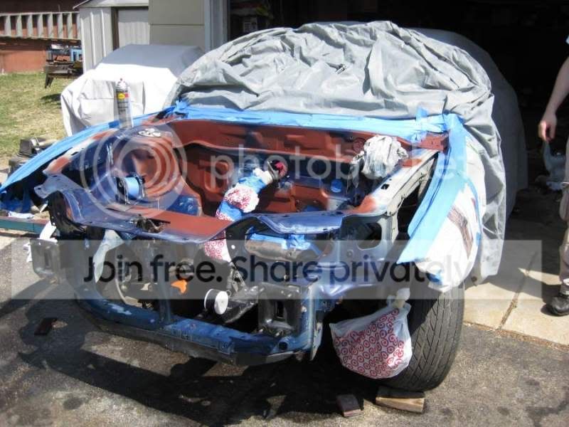

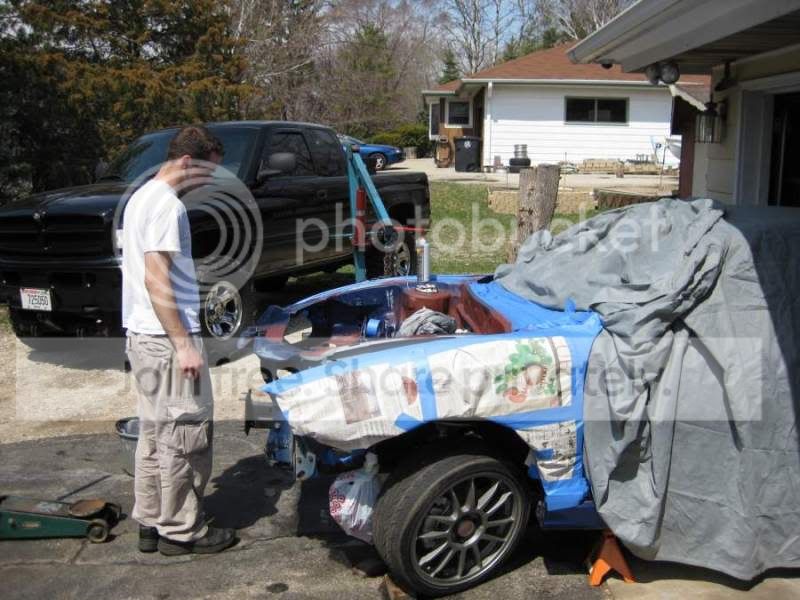

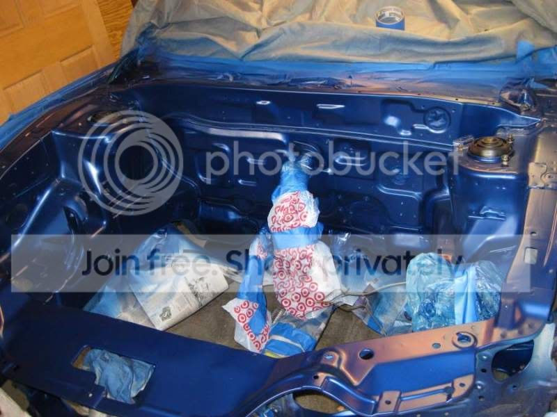

Heres a couple from painting. Engine pics to come. The engine is all put together, ready to go. Just need a clutch and Ill be dropping the engine/trans in together. Should have the turbo DSM clutch situation figured out this week and think Im going with an ACT fing02.gif

Its so nice to start fresh. It was all scratched up in there and just not very nice. Its going back together with stainless hardware and everything. Cant wait.

ah hell no, i'm doing that. i'm going with a gloss black in my engine bay. was going to do the bedliner stuff but decided not to. could you show me or tell me how you covered your fuse box up and painted around that?
Old Apr 26, 2009 | 06:10 PM
  #45
I pulled all the wiring out the hole it comes in. Then just covered the fuse box with a bag and taped it up. Then just held it out of the way to paint. It isnt perfect in that area but its good enough where you cant tell at all. Just hold it out of the way and then use a hanger or something to hold it away from the fresh paint when drying. Prep is key. I spent a ton of time degreasing and cleaning.
Old Apr 26, 2009 | 09:39 PM
  #46
Did you clear coat the Cobalt Blue? It looks different. Cobalt Blue requires clear coat to make the color proper.
Old Apr 27, 2009 | 07:37 AM
  #47
The paint I got was a base/clear. But, I am no painter and could not lay it on thick enough in the conditions I was painting in to get a good shine out of it right away. They parts you can see will be shined up with some polishing compound and wax, the rest will be just fine. It actually looks pretty nice with more of a matte finish. With $40 of paint and some prep work Im pretty satisfied how it turned out with painting in my driveway. Especially since the shop Im supposed to get a discount at wanted $450.
