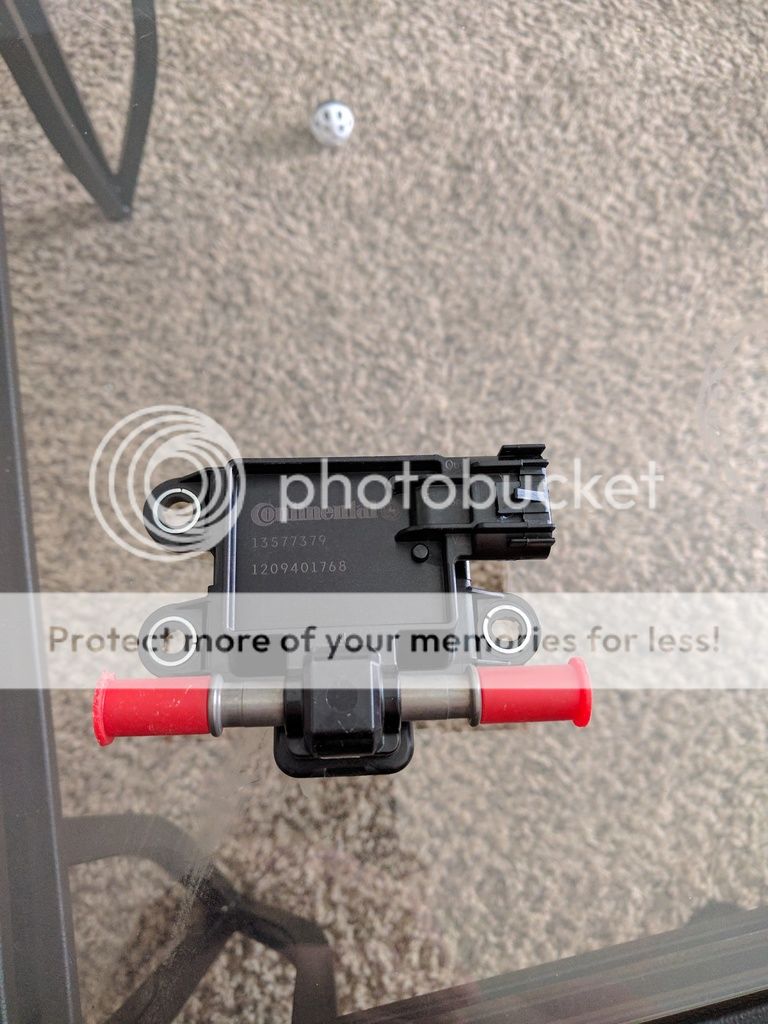

Since I'm going to be running primarily e85 and using MS3x, figured I'd take advantage of the flex fuel capabilities of the ecu. Mounted the Aeromotive A1000 FPR as well as running the fuel lines.
GM Flex Fuel sensor
