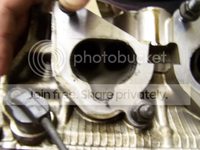

The port and polish plus cam timing cost about $800 here are some pics. Thats a few of the pics if you want to see more go to photobucket and type in dsrtibb thats where the rest of the pics are. O if you are wondering about all of the cars I own the blue civic Si (just bought it) the 06 tib and the 01 tib

DSR... that intake side of the head has NOT been ported, or if it has they did a poor job doing that it looks like there is still casting flash on there

its ported I just dont think my camera is the best ill take some more pics with a different camera and put them in photobucket
here is a pic of the intake side of the head before the port

^not ported, make sure they dont try to pull a fast on on you
