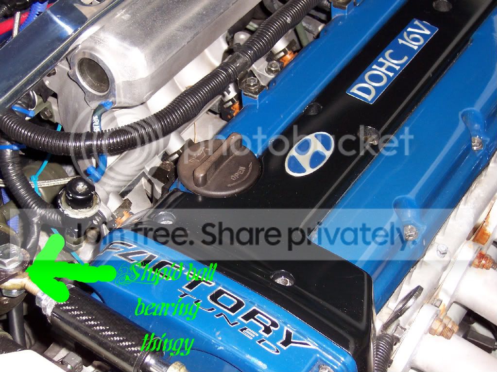

DTN, it's not an "ENGINE BALANCE", it's a vibration damper (the OEM weight/hockey puck thing you took off). Driving with it off for months, I didn't notice a difference, so no, it doesn't matter weight wise which way you put the damper. Guys, install it as the pics me and Lee have shown, and it'll work fine. CHECK yours when you get it to make sure it's assembled tightly, and like Lee said, don't be afraid to take it apart, it's easy to put back together.
And last time I checked, there are no bearings on this. 2 Heim joints, the tube and ends, the shaft, and the internals. If you really think yours is bad Adam, PM or Email BHurlin.

i didnt see DTN's post until now. hyman joints dont have bearings like REDZ said. you will definitely know when a hyman joint goes out cause you will have multiple pieces as the ball is press fit in.

Well, I think my hyman is loose. (sexually oriented explanation here). I'm about 99% sure that's the problem as I've had it off a few times trying to get rid of the vibration. Is there anything that can be done to make it press in more or take up some slack?

1.on the non-adjustable hyman end, adjust the 10" crescent to fit the slot on that end. get a tight grip with the other rubber strap wrench around the dampener tube. loosen until you can unscrew it all the way apart.
2. there is a bolt that that goes through one of the white grommets on the inside. tighten that bastard as much as you can and maybe even apply some candle wax on the threads so that it won't come apart.
3. put it all back together making sure you have that thin ribbon style lock washer on the non adjustable hyman end. if not, it will come back apart.
4. make all your adjustments on the screw end and show me a pic at the end .

No, it's the bearing itself that's loose in the sleve. the part that you put the bolt through. Maybe I'm not understanding the directions. The metalic portion that is meant to rotate, that's the part that has play. How do you tighten that on either end of the damper? I've got one on the moving hyman that is making noise.
oh, guess i didnt understand either. you can actually jiggle the ball inside the hyman housing? if so, that does need to be replaced but if its only that you can rotate, they are meant to do that. if it jiggles and rattles, contact NRG. if you jiggle and it rotates, it is working properly.
you can grease them as they have a grease zirk on that end, but i have never seen a zirk that small in my life beofre, so i dont know what the gun end would look like.

No, you won't find one like that.
Trust me, I looked for well over a year for them, ALL of these, even the $300 ones that Ingalls makes, are the exact same design (except ingalls uses a $15 damper, same one as Weapon R).
If you don't like it, sell it and go with solid mounts, but don't bad mouth it and call it cheap, these are well made, and high quality, everyone that has handled them and been in the field (Maxtibb, UrSoNvUS, DMDicks, and more), all agreed on them.
they rattle because of the heim joints, the little ball needs to be able to pivot, and that takes clearance. They also have to get the ball into the joint, and that takes clearance.
