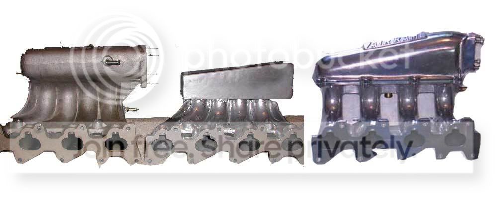

heres a little chop i did added the air ram, tried to get them to the same size
obviously the air ram is huge !
but the air ram got you beat on the ports, they are real contoured, where as, yours are straight 90 degrees.
but you got nice short runners ! good for power, quick.
you should weld on some heat sinks the the back of the manifold, on the flat side, so that it can dissipate heat, and stay cool !
that aluminum heats up in seconds and stays hot, but with some sort of heat sink, it would definetley cool, faster.
looks good, nice and low, and small.
dyno prove it !!
