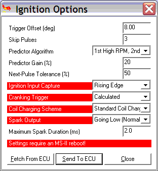

Well, that really helps! Why didn't I see that before that solves some of my problem.. we should have the same basic ignition/trigger setup (except from the advance, since you got turbo), unless you are running something unoriginal? Do you got a box like this somewhere also?
Maybe you actually now what kind of ignition system we got also?
I see your ignition advance is very low, is that because of the turbo setup? I think mine should be from 12 to 23 degrees (at 100kPa).. does that make sence?

we have a waste spark setup. which means 1-4 and 2-3 spark every other time. Its called a waste spark because even on the exhaust stroke it still fires on that cylinder. Yes my spark map is a little on the retarded side . you should be around 32 degrees advanced at wot and high load. Highlight your ignition map from 2000rpms to redline from top to bottom and at the top right hand corner input 5 and hit the plus sign. That will advance your highlighted area. If you want I can rig a map up for you to try. When you turn on your car without starting it, what does your map sensor read in megatune? Your elevation will effect this number. For example mine at 3550 ft. reads 86 KPA with the motor not running. The closer to sea level you are the higher this number should be.
