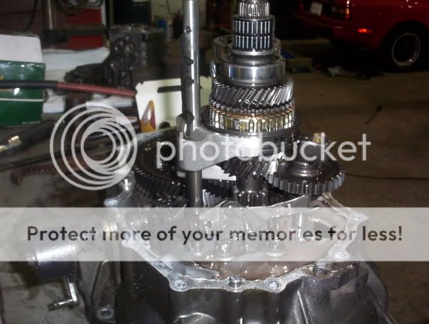

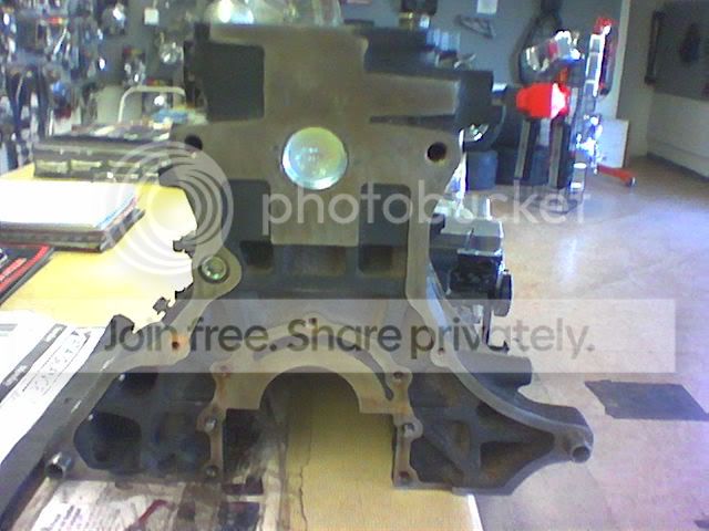

I've seen an AWD tranny online, but I can't seem to find one locally.
edit.......Hmmm, maybe it was the Eclipse motor that I saw, cause it looks like the EVO tranny won't bolt up. Not even close. Notice the starter is in the front lower end. And from lookind at our block, it looks like the top two bolts are higher on ours. And the two lower ones on the EVO are stagered.
edit again....... Ugh. The Eclipse motor looks a lot closer since the starter is in the upper position, but still looks like the top two bolts are lower than ours.
EVO:
Eclipse:
Beta:
