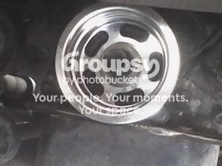

Alex, Thanks for this guide. I finally have the pulley installed. This is really cool stuff. I can really feel it at the start. Now I can take off with second gear, no hassle. smile.gif
I didn't remove the front right wheel and this was my fourth time removing this pulley so it easily came off.
