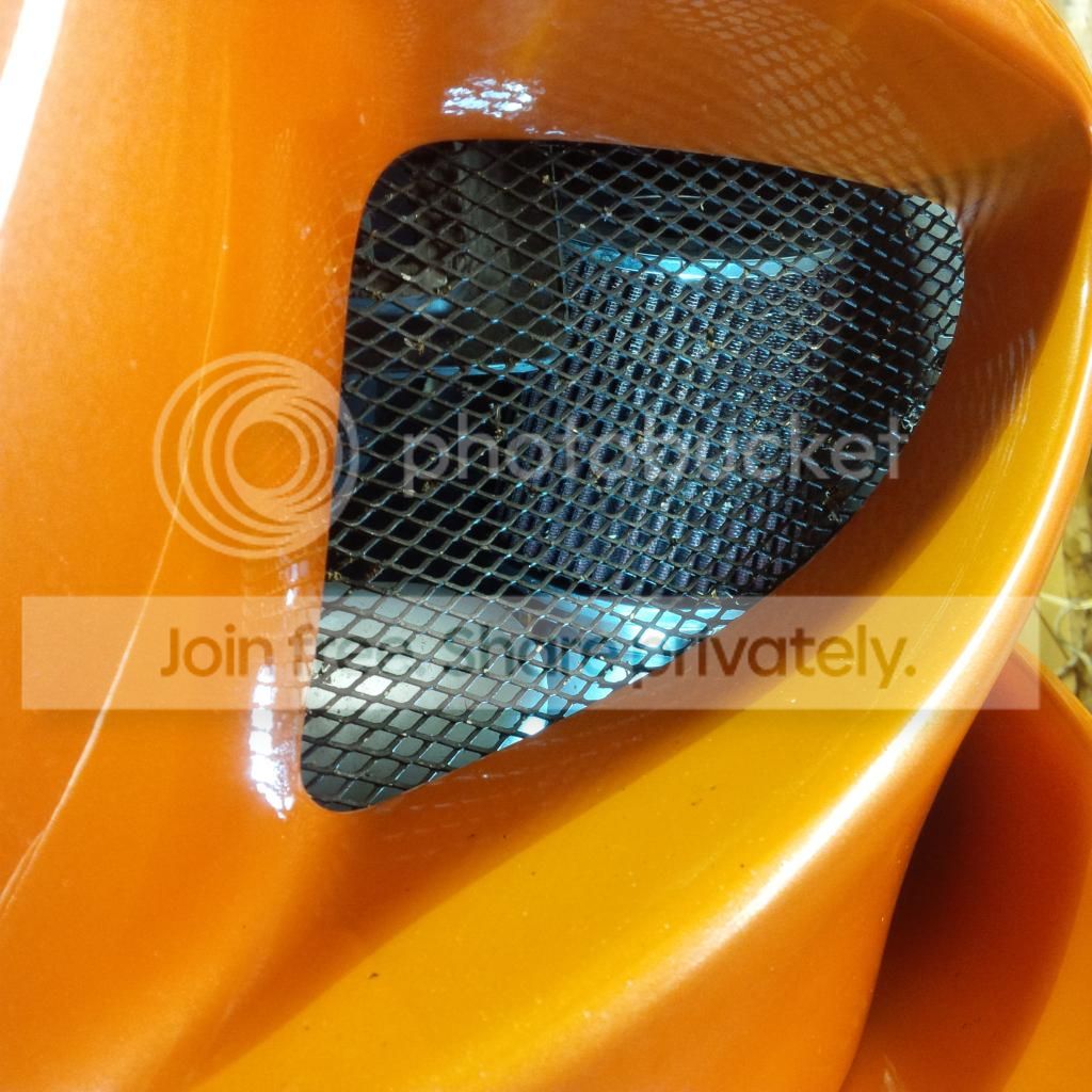

^^ I usually take lots of trips during summer,usually 6 plus hours of driving, My wife and I are approaching 50, solid mounts would just make our ride rougher.The polys are great for daily(almost stock feel) and perform at the track as well..
more pics...
