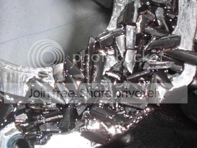

I was just cruising in 5th gear on the way back from the Drag strip. I was around 3500 rpms and mashed the gas as soon as I hit full boost I lost the gear. Power Levels 265 whp 289 TQ.

QUOTE (Gary @ Dec 18 2005, 01:20 PM)
My Webpage?
linky no worky.
u got to post the pic if u do not want your photobucket public.

Gary,
Believe me, I always thought 5th was the weakest gear (and it may be) before I came over to Korea, but I've talked to the actual President of VHR clutch systems and over in Korea 3rd gear is the biggest culprit. Perhaps it's because there aren't very many opportunities here in Korea to fully boost 5th gear. Anyways, there are MANY people here in Korea running 300+whp without any transmission issues. Myself included.

Gary, what was wrong with 5th gear? what broke?
