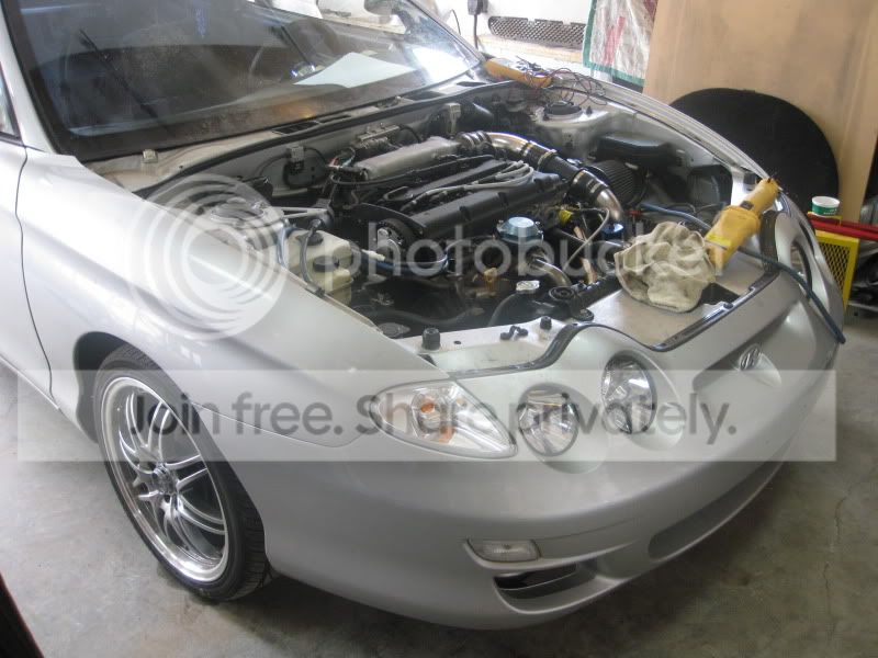

Just a little update. Over the past few weeks I've been picking away slowly (VERY slowly) at this. Today I finally jumped on this and spent the whole day finishing up the electrical and other little things. I have all of the electrical completed, installed my newly painted calipers, painted my gauge pod, installed both fenders, modified and installed the bumper, did a small modification to the bumper cover (removed the grill), wired and installed the steering wheel (what a f***ing pain in the ass, seriously, they should make an aftermarket clockspring). I believe the only things left electrical wise are running a wire from my engine fusebox to the oil pressure sender, and the greddy turbo timer. Only other major thing is to reinstall the vacuum lines once I get my manifold from tanc, and then I'll just bring the car into my shop one day and use the hoist and mig welder there. Preinstalled the APE traction bar bracket, just need to weld the brackets onto the control arms.
I'm putting insurance on it for July 1st. If I get the vacuum manifold by friday it'll be running next weekend, otherwise the following weekend.
A couple weeks ago while trying to remove the oil plug in the head, I ended up cracking a chunk off the head. I ended up filling it with lab metal from Alvin products. We've used it at work a few times to patch oil pans and stuff, we'll see how it holds up to a bit of heat and pressure (says it's good for up to 400 for 20min so it shouldnt be a problem).
Once it's running on its own power I'll throw in the 440cc injectors. Still waiting on an FPR to install the walbro 255.

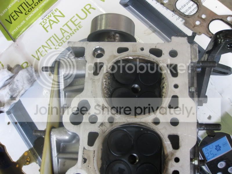

In my last post I mentioned a cracked part on the head. Unfortunately due to the location of the damage, I wasn't able to clean it good enough, and my patch job leaks where the new piece meets the wall of the original. Not spraying oil, but it creates a steady drip. So it looks like tomorrow I'm going to have to pull the head. I could flip it over and do another patch job by cleaning it properly first, but since I'm pulling it I may as well just find a good TIG welder to do it right the second time, I don't want to have to mess with this again.

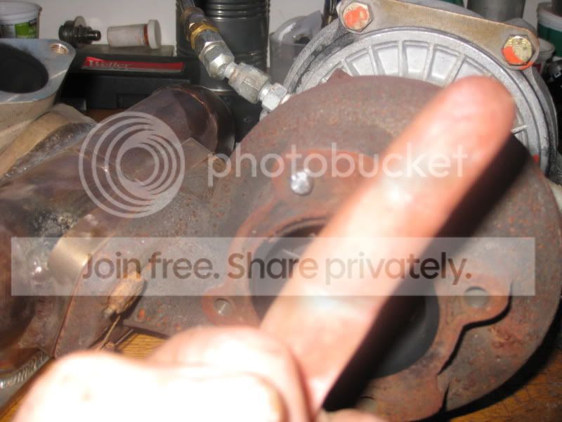

Here are some pics from today. Got the head off, took 3 hours.
So from this, I broke a bolt off in the turbo, and am assuming that t4turbotiburon was running lean in one cylinder. (this was his engine)
The first pic is the damage to the head, I don't have a pic of my patch job but it was decent.
Anyways, this is where I am now. I'm assuming that it's OK to run with the cylinder in that condition? I was thinking of taking a dremel to the scored part of the head and smooth it off, but would this create a significant difference in the volume of the cylinder? I'll probably replace the piston next winter when I rebuild the turbo system.

That 1 cyclinder is eww....
Wouldent use a dremel..

Well to make a long story short, this project is going back to square one. The engine was f***ed from the beginning, and due to takign a shortcut, I bent the valves in the head to pretty much seal the deal.
Now I have a new plan of attack; one piston was pretty much toasted, and took the cylinder with it. I'd rather not have to deal with more issues with this motor, so I'm going to pull it, take the knife edged crank and the rods, and swap them into either a: my old block (about 60k on it) or into a beta 2 block. Either way I'm getting a beta 2 head, but I'm thinking I'll be better off with the beta 2 block anyway. Only question is will the crank swap nicely?
