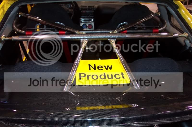

You're right, that's why strut bars never have bends in them. Wait...

i wouldnt be opposed to it if you could do it in a "Z" pattern so you could have upper and lower b pillar bars in one set up. now that would be great for harness

thats what I was thinkin socks, took me until my second sentence up there to realize that. The problem is cutting the plastic would look crappy but it could be done and wouldn't be hard to do at all

the thing with a 'Z' bar would be over the top and there wouldn't be many people on here that would want something to cut off complete access to the back seat/area.
an upper bar would be plenty for a harness and stability.
capn, depending on the bracket design, you could make the cuts look decent.

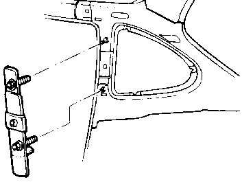

honestly-... how well would these work?
i'd only assume that the track (that the seat belt hanger is on) is most likely not part of the actual unibody, but a part that is bolted to the unibody. i just think it's not a very rigid point to bolt into-...

i would defiantly not use the seat belt(bolt on adjustable part). thats about the worst mounting point to consider. id say in my own opinion it would do nothing to prevent chassis flex(due to the adjustable slider flexing instead of being stable). heres a pic of seat belt components for reference on what I'm talking about, its the inside the belt that will flex.

01steve - Were not talking about attaching at the height adjustable bolt. Socks is saying you could bolt it to the top bolt that holds the adjuster plate onto the unibody. Heres a pic from hmaservices.com

I was always silently wishing someone would make one of these for our car. I saw it at SEMA a few years ago. I believe it was even the same car as the ebay link(Integra).
