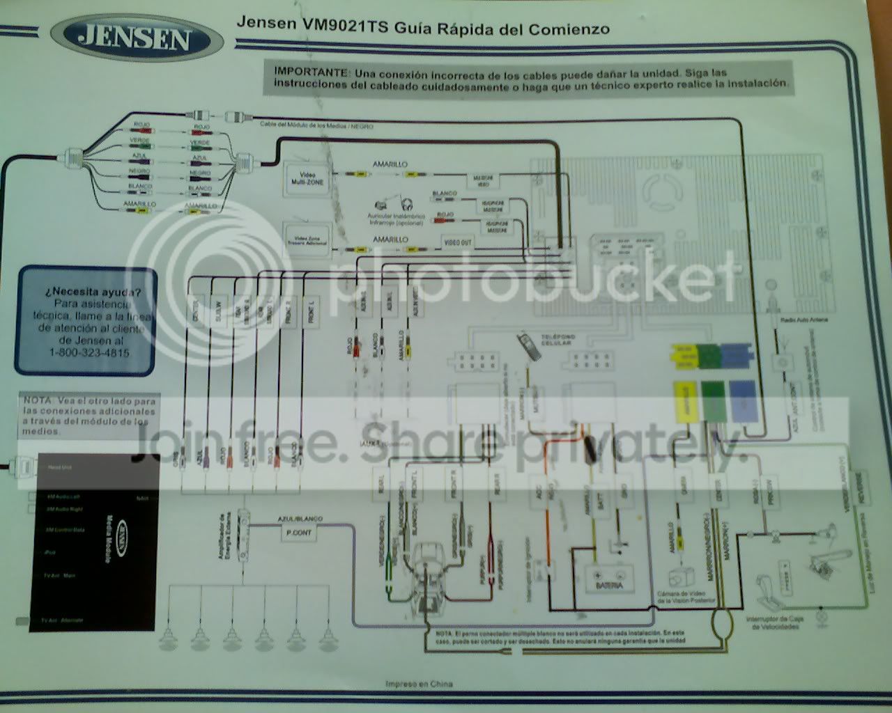

^^ that would not fit behind my Jensen VM9021TS. I've got 19 separate RCAs, 18 separate wires, A separate J-Link connection, and a proprietary connection to a separate 1/2 din DVD decoder/break-out box all in that little space.... Not to mention the antenna wire.
That is the easy way of doing it, but not the most pracitical in alot of cases. Besides, it costs money.
