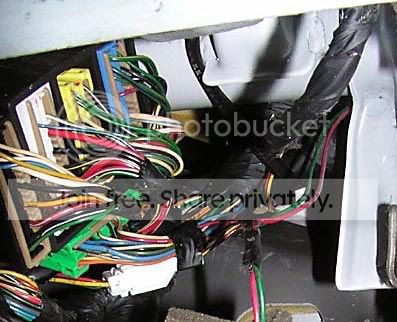

to make the install easier on you, you can find brake, park lights, and door pin in the kick pannel in the harness that runs to the back. and you can also do your ground there too... makes for less running around to do hook ups. all wires are same color.. just test them first!
heres just a little show off i will use on installs!
this pic is joe schmo installing on his dodge ram
this is me on the same dodge ram
