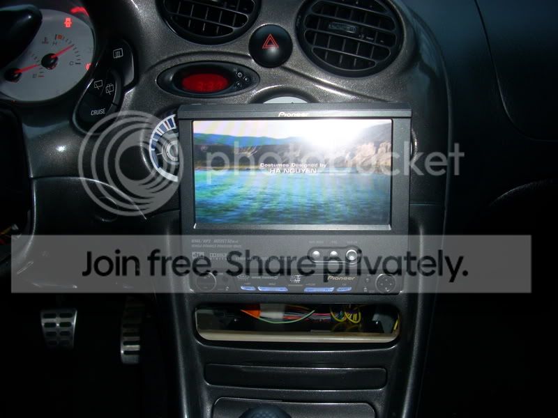

Ok, I think I answered my own question. I found another manual specifically for the ipod adapter, and its telling me that I have to connect the power and negative wires.
Yes, I am teh bestest evrrrr:
Now I can bring Mark Wahlberg with me wherever I go! (I was watching Shooter, lol)
also there's a sneak peek of my new dash set-up, I repainted my dash gunmetal (again), and you can see my new momo shift knob, which will match my new momo steering wheel which I scored for $66 (It's a $250 wheel) smile.gif
