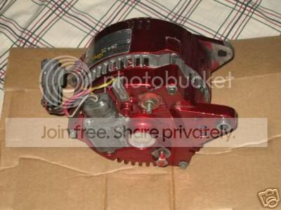

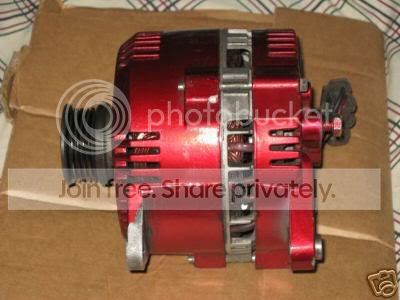

Edit : Here is an example.
This is a custom wound 200 amp alternator made by stinger.
And to show you what I am talking about.

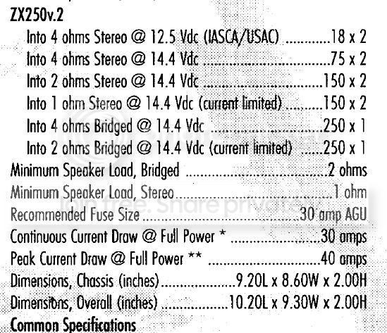

Look at the rated output on my amplifer at 12.5v 18w x 2
Then look at it running into 2ohms with 14.4v being fed to it, See my point? with 14.4v of clean power the amp runs 150w RMS x 2 instead of 18w.
And when the amp is doing that (imagine how bad it is at 0.5 ohms?) it is drawing it's power from the battery which is getting it's power from your alternator.. If the alternator cannot cope and provide the battery then the battery cannot cope and provide the cap, the cap only stores what it is being fed and saves power for bursts.
Those (battery and cap) will not fix the problem, you NEED a good alternator.
Stock one is like 60 amp or so on the RD1 IIRC and around 100amp in the GK, those stingers are 200 amp.
And yeah, I know the amp manual says peak draw is 40 amp, but thats one amp.. I run 3 and one runs at 1ohm curently and will be going to .5 when I get my tangband 6x9s in the back shelf.
So at .5 ohm the PG MPS2220 will draw around 70 amps ALONE, forget the head unit, active XO, basscube, AND that zeropoint in this pic thats taking 40amps at peak power.
Doesnt leave much for halogen headlamps huh?
