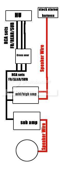

Gen1x - most modern cross over use pre-amped signals because its RCAs' coming out of the deck not speaker wire
example:
you can see where its RCA's on both sides beacuse the signal from the HU comes here and you cut the sounds out before you even power them.....WHATS THE POINT IN POWERING FREQ. THAT YOU DONT WANT TO HEAR???
its at this point that the the RCA's plug into your sub and mid/highs amp and its powered up and converted to speaker wire, which in turn go out to your individual speakers.
after the amp and before the speakers you have another chance to cancel freq. you still think are out of the speakers range these are mostly small capacitors like this
or like those pictured with these tweeters
they go inline before the speaker on the positive (red) wire they are soldered in place. alot of times on the tweeter or midrange themselfs
example:

made a diagram of what i'm talking about
RCA's are pre-amp signal and speaker wire goes to stock harness and out to speakers in the car. you can add the capicitors locally at each speaker during install of the speaker. this is something that is speaker specific and will change as they system changes.
now the tweeters i have are to large for the stock spots so i have them on the dash and the wire is just tucked behind the dash so im not sure how to help you on that part. my RD2 didnt have premium sound so no tweets and no CD player just a weak ass single DIN cassette....cassettes in 2001 WTF were they thinkin??
