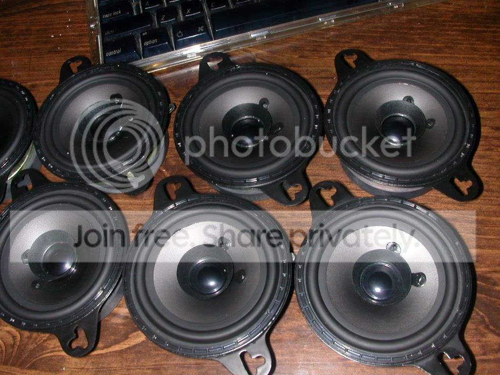

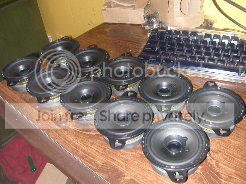

Today I got the new speakers for the vent holes. The ones I originally wanted still weren't in stock but I found these on ebay. They are all brand new Polk 3.5"
I got 5 pair (yes 5!) for the same price as the one pair I wanted. (I love ebay lol)
They fit nice in the door not in permanently yet.

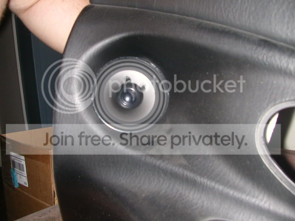

Posts: 709
From: Pennsylvania

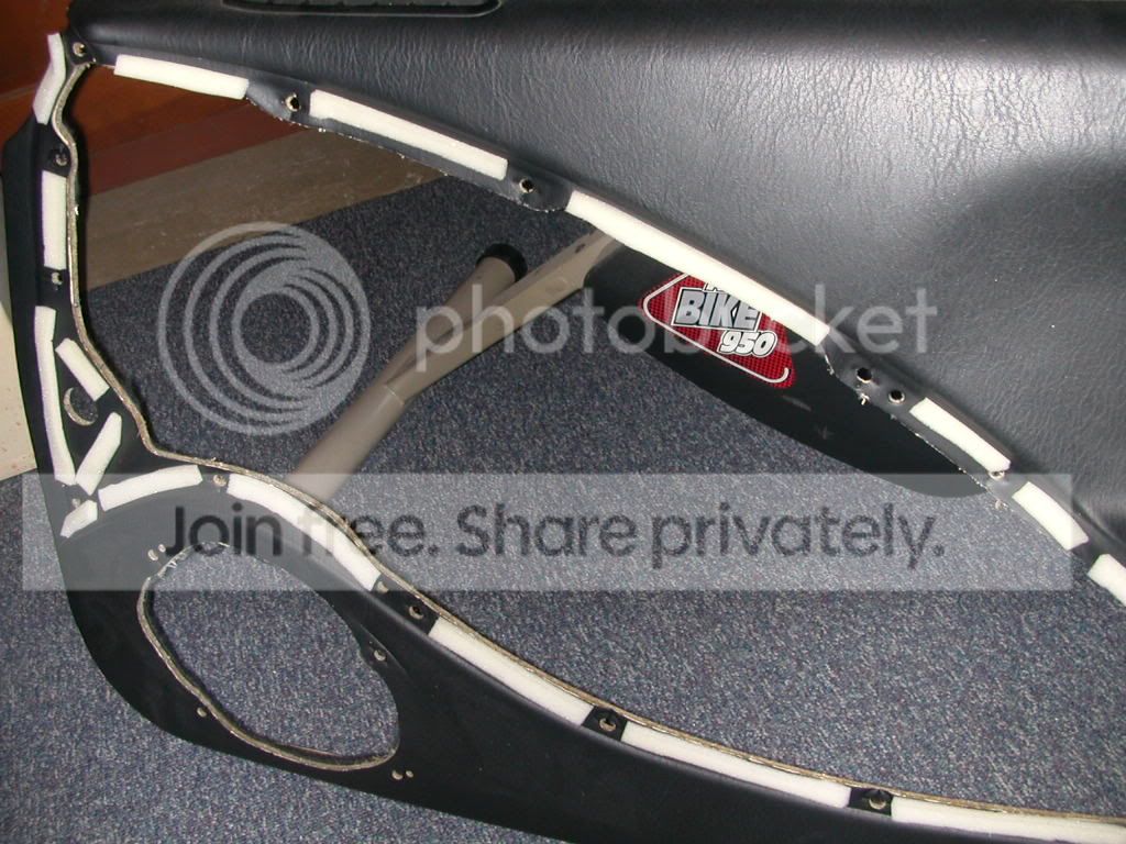

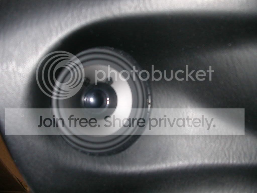

Time for another update.
I had these finished for a while but didn't get to posting them.
I put the grilles in and mounted the speaker but forgot to get a pic with the speaker in:
The white is foam weather strip for sealing house windows.
There is no squeaking from the plastic or noise now at all.

looks very good.. can't even tell that area used to be a heater vent or has been changed at all.
i really like how you went all the way with it, to keep your heater functioning well instead of blowing most of the heat inside your door panel if you didn't fab the new ducting.

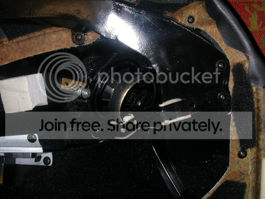

Posts: 709
From: Pennsylvania

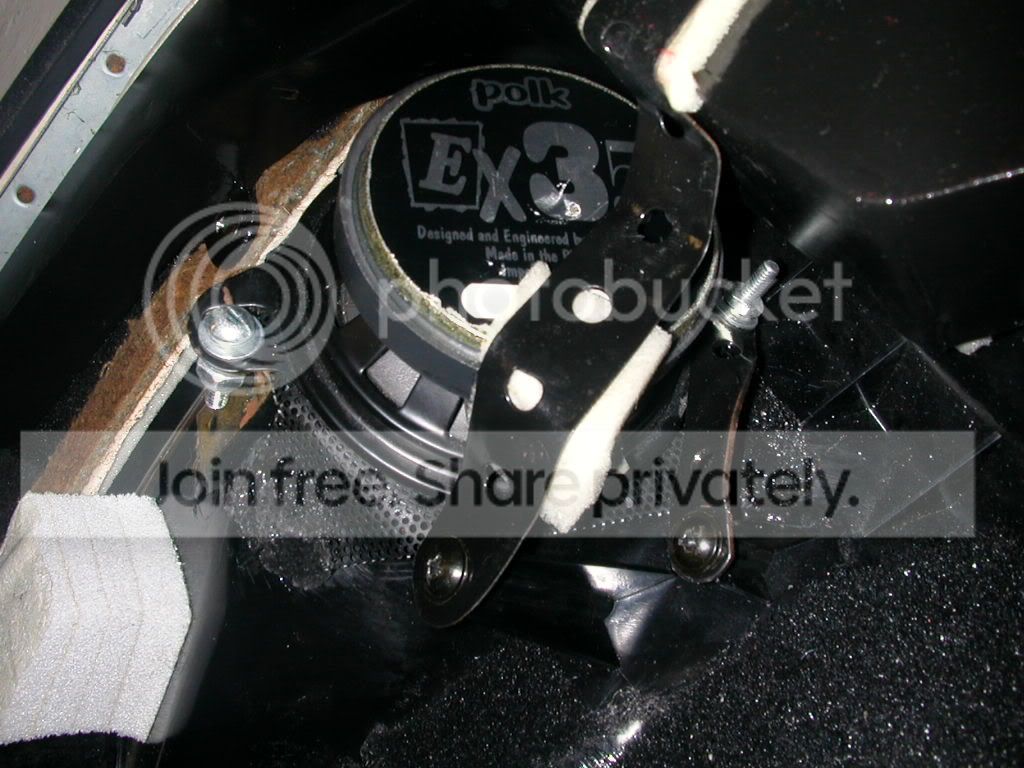

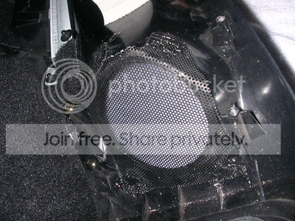

These were burried in the basement behind some junk and I finally cleaned up so I took pics again.
Heres how I mounted them you can see there isn't alot of room:
I cut up some old speaker grilles, bent them to fit, and glued them on with silicone.
Then I bent up some small brackets I had laying around to mount the speaker. I had to glue one with epoxy and the other mounts to a factory screw location.
The strap is there just for some extra support from vibration while driving.
Its not pretty but no one will see it anyway. I am going to paint it all black anyway just because I will know what it looks like lol.
When I finally put them back in the car I will put some foam or something behind it to seal it off from the rest of the door.
