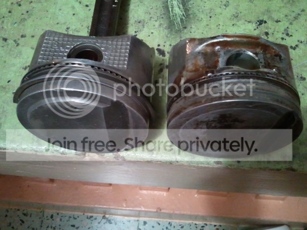

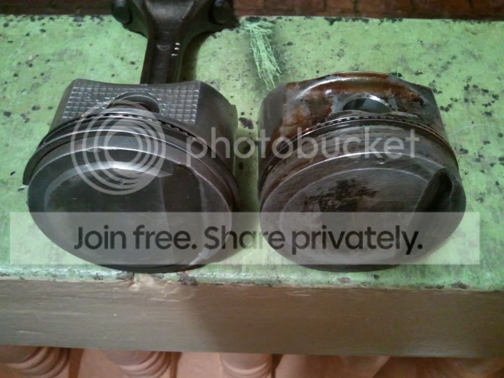

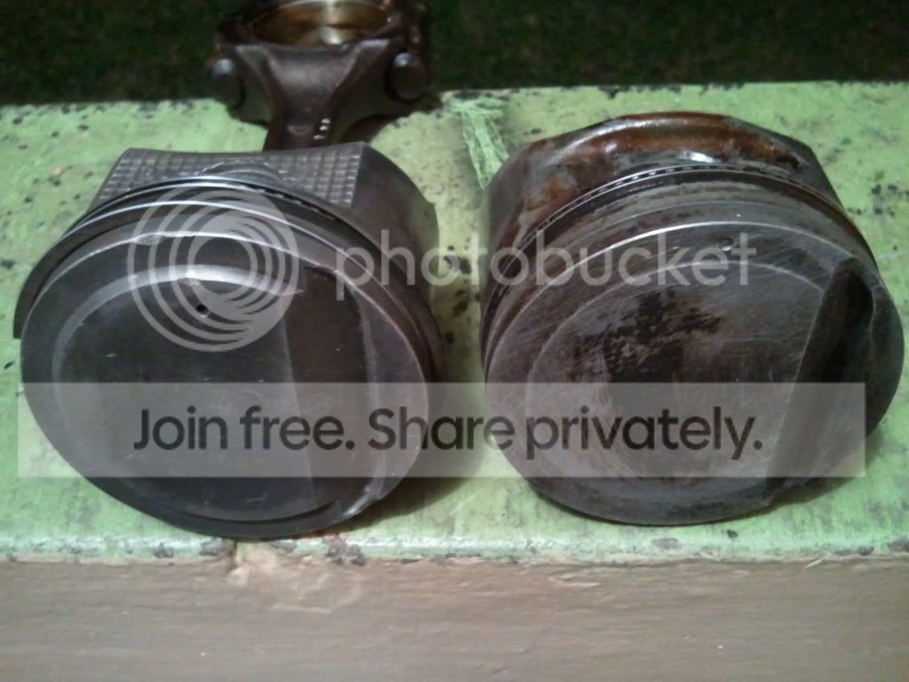

I was in bluewolf47's and he was messing around with a few engines!

theres clearly a huge difference there, but theres not in the 1.8 engine I looked at, both have the one on the right. And ask Hyundai over here for 1.8 pistons and they supply the same ones as a 2.0.

Juanra thanks a bunch. That's what your 2mm raised dome looks like eggcatcher.

No problem, I saw them in the floor and remembered this topic.
