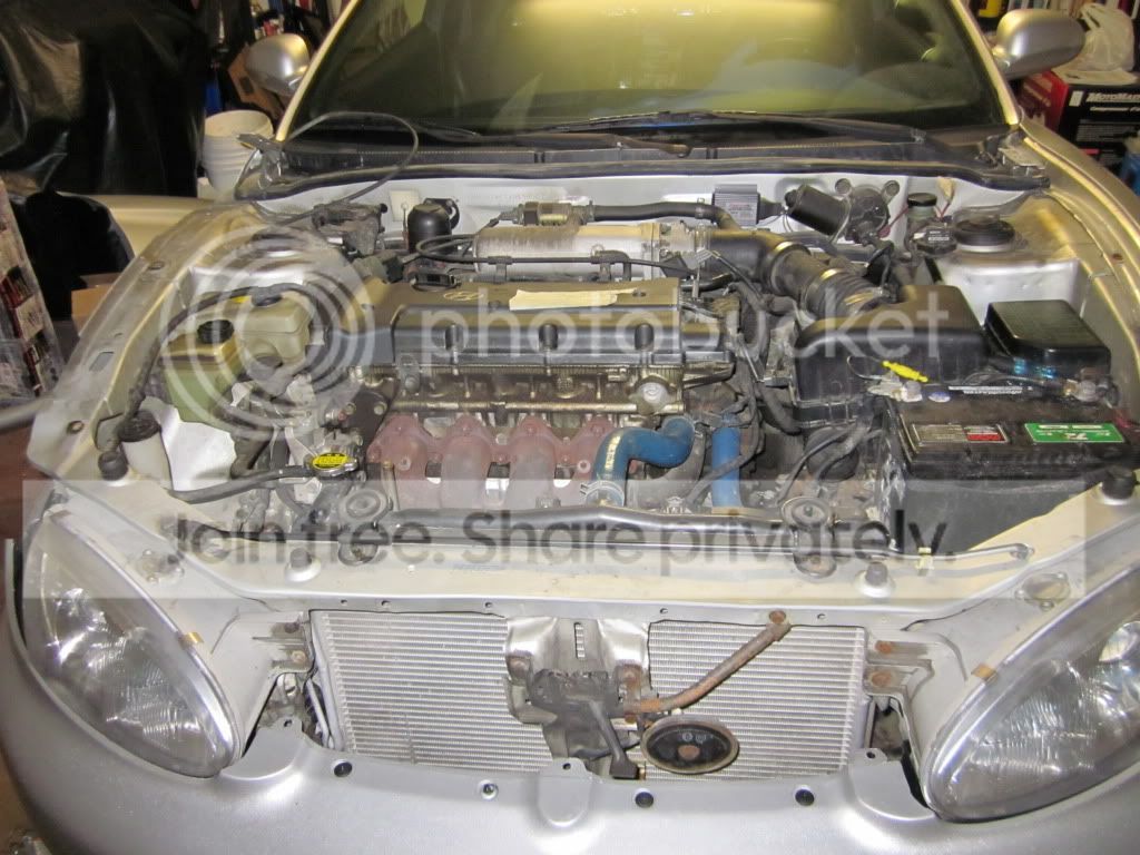

Here's a pic of my engine bay before the engine removal:

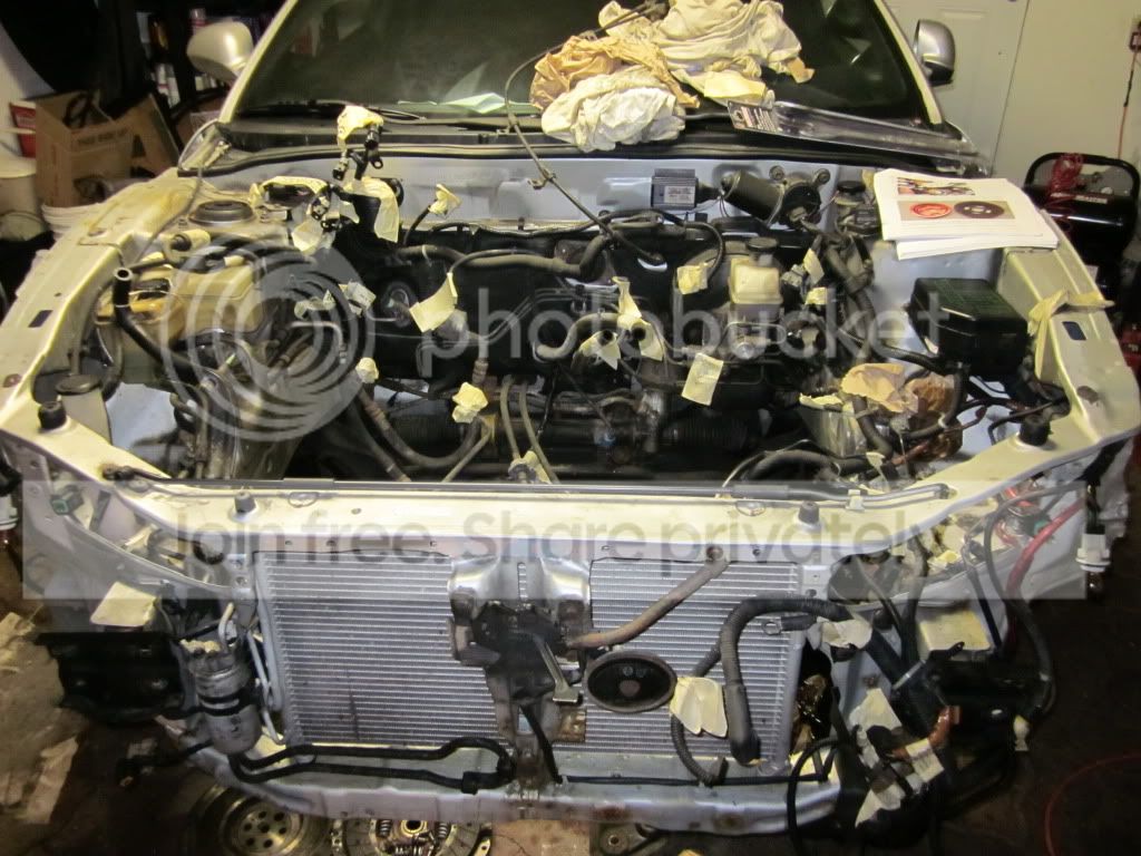

And here's one of it after:

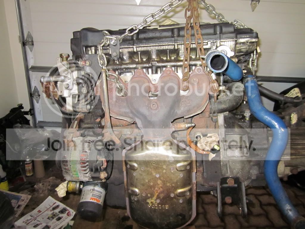

Here's the engine out:
So I found a guy, local to me, selling his beta2 2001 Elantra engine for $100 (80,000Km, approx 55,000miles) and beta2 tranny, same mileage, for $100 = $200 total.

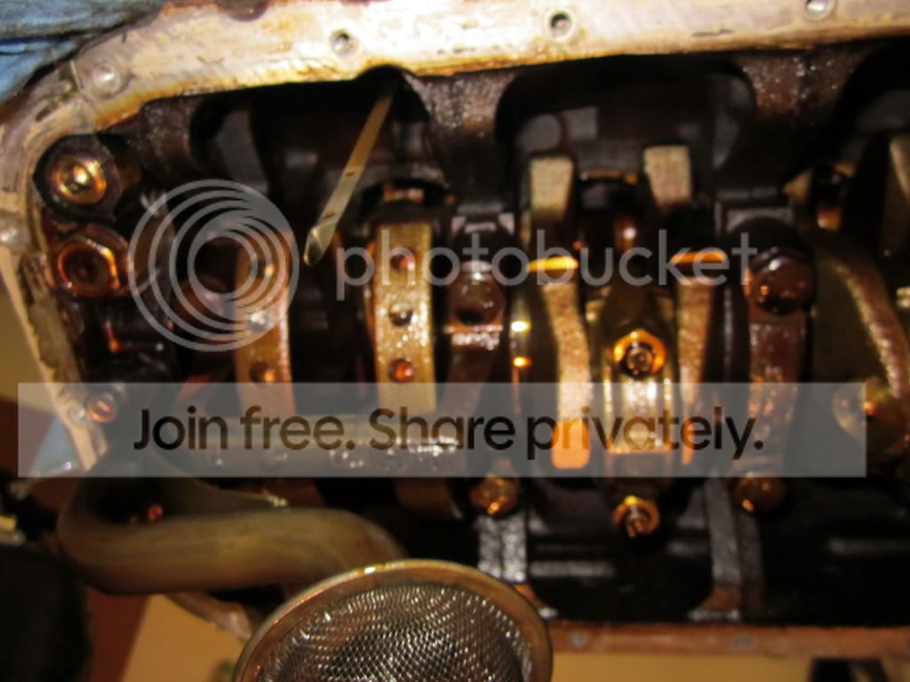

My beta1 piston rings looked like crap!!!! WOW! There was oil all around the actual piston (where the piston ring is).
My beta1 IM, has a bunch of black soot/oil in there! Why?! Could it be blow-off from worn out piston rings?

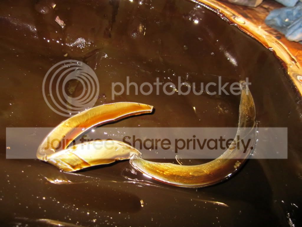

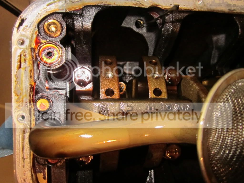

Look at what the heck I found inside my beta 1 oil pan!!! What the heck is that?! I looked around in the crank case, but couldn't find anything missing 2 metal pieces. Where do you guys think this came from?
Oil Restrictor. You guys told me to remove this on the beta1, but I can't find it. Here are a couple of pics. Can you guys identify it? Faitho?

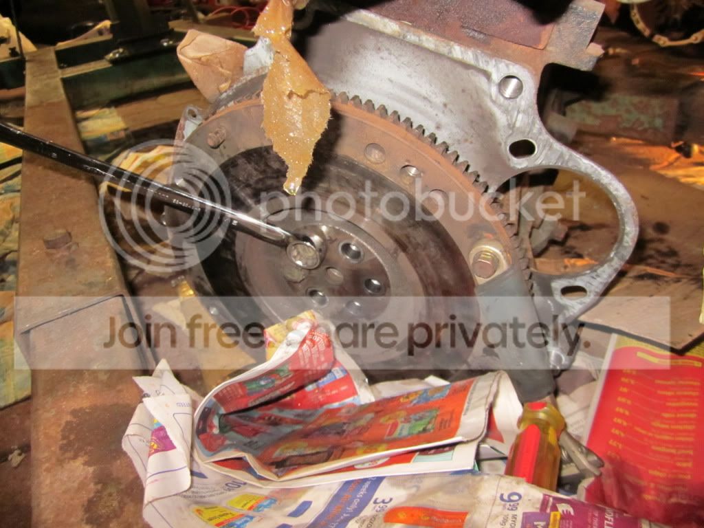

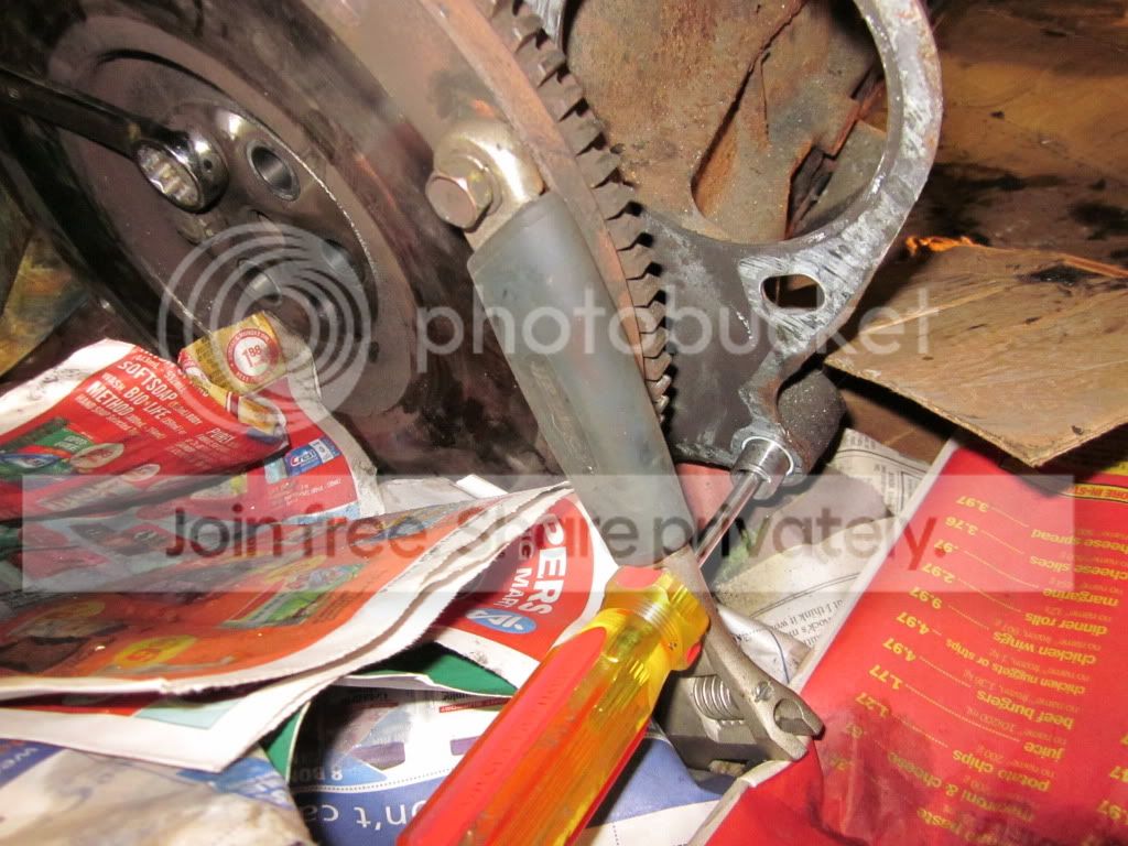

I also wanted to share a tip for removing the flywheel bolts:
Flywheel Pic1:
Flywheel Pic2:

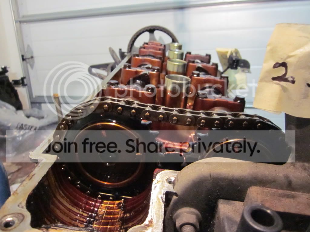

Pic of Beta 1 Head:

The restrictor should be in the top of the block, it blocks oil flow to the head.
+1 rep for a most excellent bolt removal method technique
The mysterious metal crescents are thrust bearings. They prevent crankwalk when they're not bent up and laying in the oil pan.

You should take the fly wheel bolts off in a star (criss-cross) pattern. That will eliminate pressure which can potentially warp the flywheel. In the past, whenever I've removed the flywheel, it was always my intention to replace it. Even still, I took care in case the flywheel needed to go back in.
To get those flywheel bolts off I use the palm-impact technique. It's not beautiful, but it works. Take a big 12pt wrench, and smack the end of the wrench with your palm. When fighting against the locktight that Hyundai installs, using an impact wrench is better then just pushing against the bolts... of course. You used a good method.

I'm trying to figure out what the red color in the head is caused from. My engine was nicely yellow tinted for years, then it overheated once. From then on my valve cover was reddish.
You can just tell those who've got years (or decades) of experience! Man, I was just smiling how you guessed it, but you got it! I went on Rockauto and checked out the pics. This was exactly that: thrust washers. I guess I'll let the machine shop replace it for me. I have to admit that I hate having others work on my car. I've had bad experiences with job quality, when others do things.
You're right DTN, I should've removed those bolts in a star pattern. I'm replacing the flywheel with an XTD, though, but still, you're right.

I don't know what the reddish is from. I was wondering the same thing. The other guy's beta2 cylinder head was a bit more pinkish than mine, but still had some red to it. Not sure why.

LOL years of experience. The first time I saw a set of thrust bearings fall out it took a minute to realize what I was looking at.
My flexplate bolts were totally resistant to handheld trenches to include several feet of breaker bar and a mallet, with penetrating oil. It took 120PSI on the impact gun to get them going. Then of course they came out like nothing.

I am pretty sure the red/orange is from cooked oil. I've always run good quality synthetic oils and occasionally Marvel Mystery Oil and my head looks like fresh metal with fresh oil on everything. I got a cam from a head that was red inside, and the red washed away in a couple of weeks, now it looks like the rest of the engine's internals.
