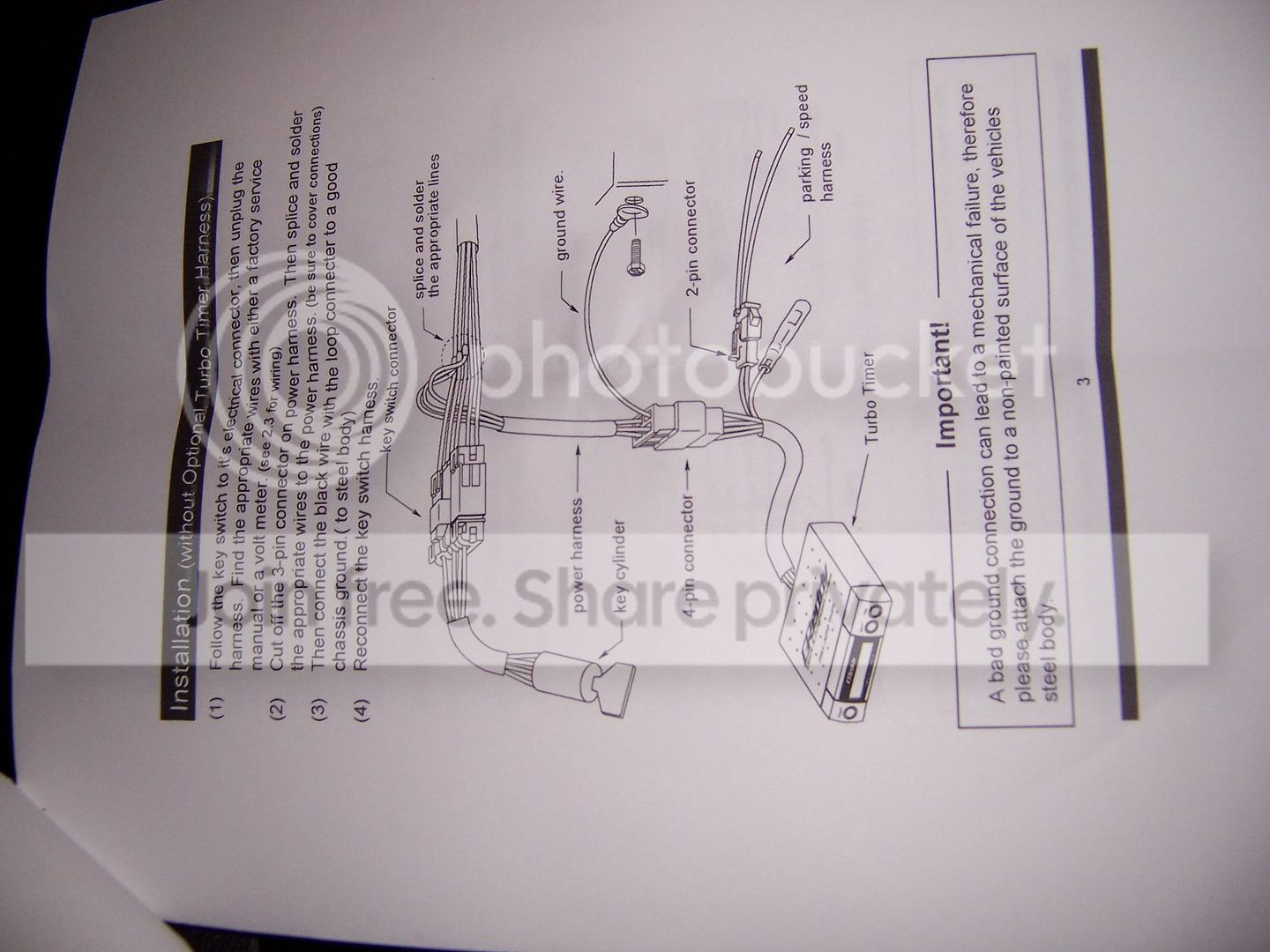

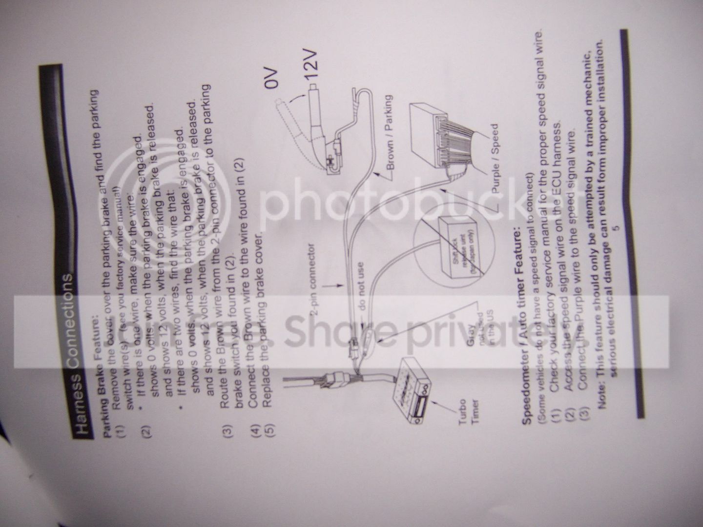

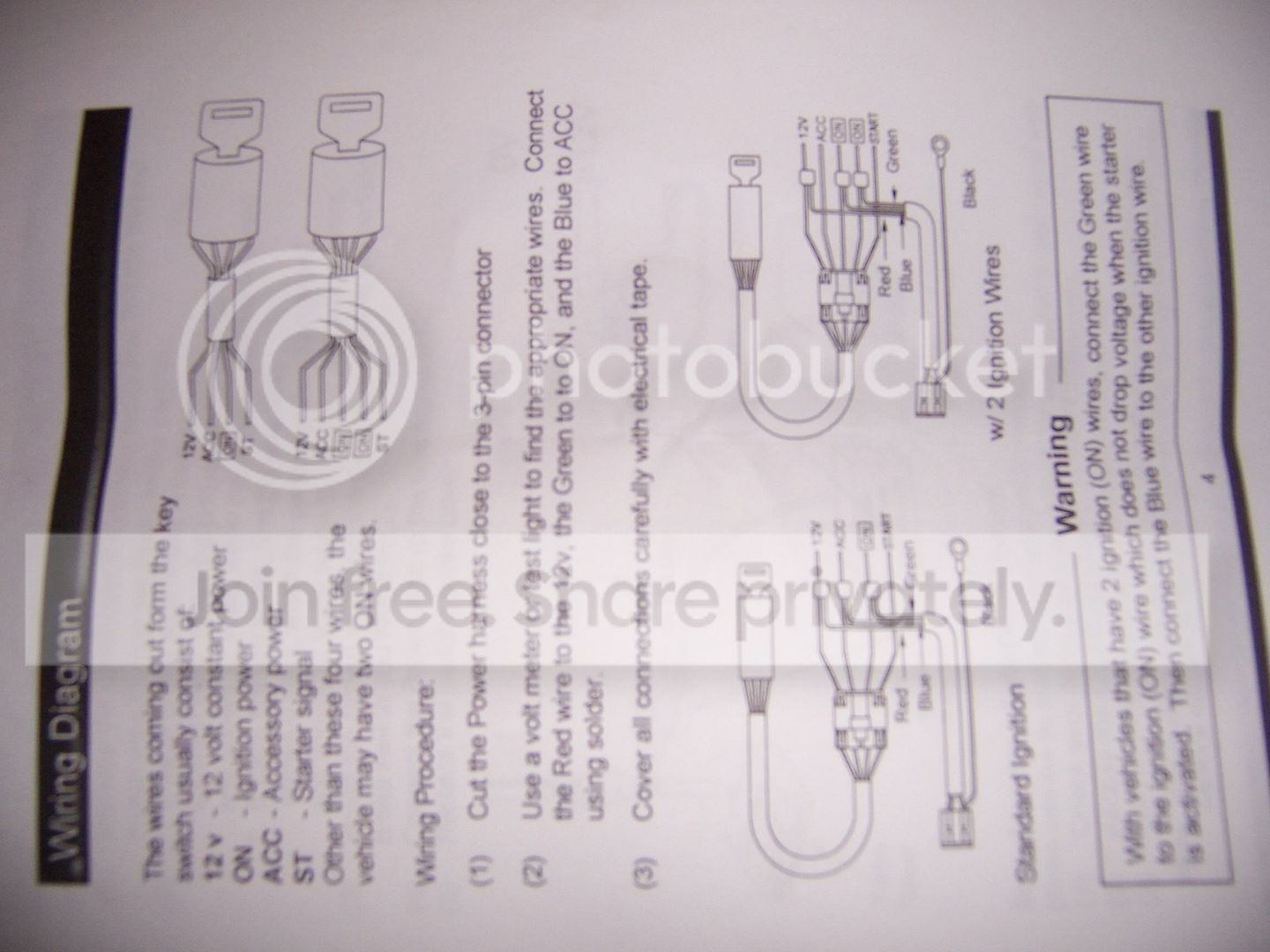

LOL, good timing. I so happen to have a greddy turbo timer "full auto timer' sitting on my desk for my buddy's evo project. I dont' have the manual. One is for power, one for ground, one for switched, one is not used, and the other is for 2 stage hot-at-on.
Do you have the manual? We had to sort out the wires... I could take pictures of it if you need.
hope that helps
Old Apr 12, 2009 | 06:45 PM
hamhead's Avatar
Posts: 4,722
Manual I got was in Japanese, lol.
Helps in that it shows me what each wire on the Turbo Timer itself are for - still need to figure out which wires to attach that to on the Tib. Think the Ignition Clip has a big blue one, a pink, a gray, a green, and another color.

I got it installed, wasn't too bad. Just had to play around with a test light for a bit when I took a trip home.
