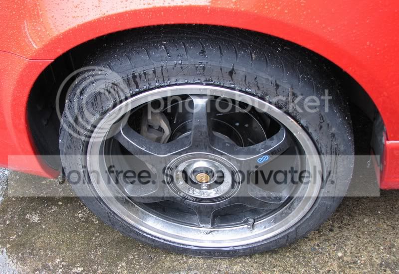

Pics:
Drilled and slotted rotors

Old Apr 7, 2008 | 02:07 PM
Whiplash's Avatar
Posts: 3,088
From: Windsor, Ontario
Vehicle: SRT4/Neon SOHC
That does look slick. Very nice.
