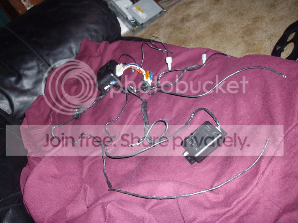

pull the alarm out and fix the wires they were tapped into
alarms are only like 5 wires anyways

I actually just finished doin that haha, all that's left is I'm waiting on my dad to get home with his wiring stuff, to cut it and splice the ignition back together. Here's a picture of everything (the relay is still in because I didnt cut it so he'd know what to look for)
Old Apr 8, 2010 | 02:02 PM
You should be good to go now. Let us know.
