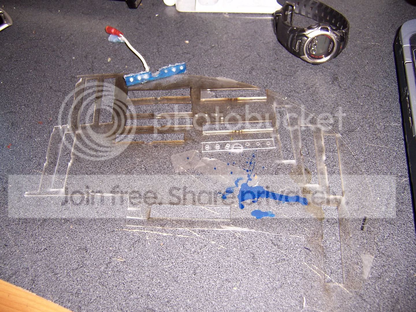

Well, round 2 went poorly today. I built the new style LED purge illuminator (picture below), hooked it up and dry-purged the system to test it a few times. 3 LEDs went out durring testing. I hooked it up and purged it really quickly, but I'm sure it was nothing like what it will look like when i manage to get the LEDs working..
It turns out that the reverse EMF of the inductor that powers the purge solenoid has a HUGE reverse EMF inductive kickback. With the size and weight of the coil, I'm assuming at least 20,000V reverse EMF. I really should have thought about it, or the engineers of the solenoid should have thought about it.. either way, i feel like a jackass.
So I replaced all of the blown LEDs and resistors, added a reverse EMF diode to protect it all, and it should be ready to go as soon as I get some light to work with.
Round 1 failed because of the precision cuts and rapid heating and cooling. Round 2 because of electromagnetic feedback from the solenoid,Tomorrow it's round 3.. Hopefully 3rd time's a charm.
