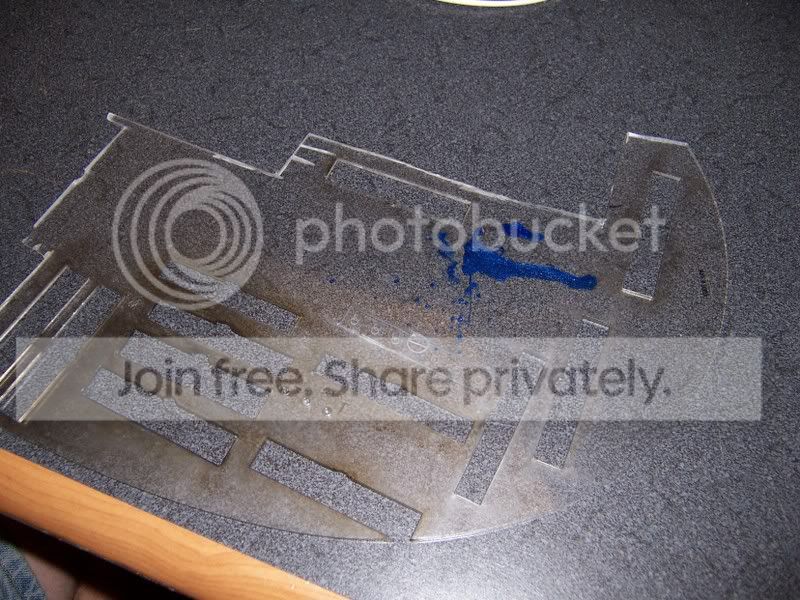

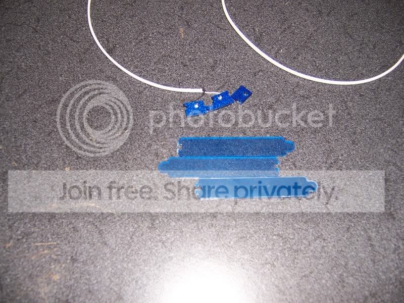

So a local place opened up which does laser etching. I figured, what the hell... I need some holes cut in a piece of plastic. I brought my hand-made prototype down and we came up with a real soloution for the problem. I speciffied that I wanted 3.1MM holes and it needs to clip onto my purge valve. I supplied the acryllic. The guy worked with me and didn't have a problem because the machine does all the work and he's not using his own material, he's using mine. We made alot of prototypes before I was completely satisfied.

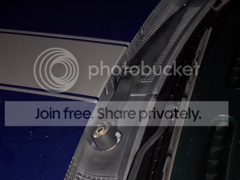

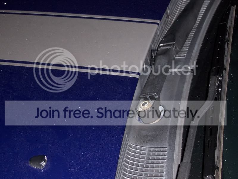

The tip of my purge valve is made of a BIC pen. It looks good, and you'd never be able to tell it was anything other then a threaded piece of plastic. It looks good and that's all that matters. Otherwise it would be a piece of metalic pipe. BTW... the pictures show nitrous purge dust. When you purge nitrous, it flashes to white and freezes. It will evaporate soon.
Anyways... I start putting LEDs in this sucker The holes were cut precicely to the size of an LED at 60 degrees with a micrometer and autocad. It's now a bit warmer out and the plastic has enlarged, making the holes smaller. Note to self... tell dude to make holes 3.1mm AGAIN!
So i'm intermittently purging the sucker, and all the sudden the 2 LEDs that are actually mounted start pointing the wrong direction durring testing.. Well, the nitrous froze the plastic and the tollerence became smaller. I'm going to use a different material next time. The plastic pieces on the bottom should work well because they're not as brittle as acryllic.
