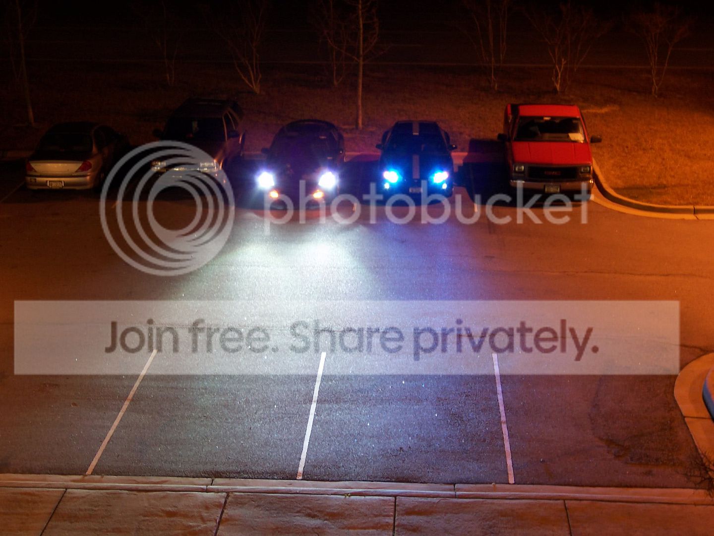

6K next to 12K.

woahhh.... so blueyy
the 6kk blub just like over lights your 12kk. it looks nice but can u see much at night??
i was goin to go with the 6oook hid conversion cause the further u get away from 4300k the less visiblity you have. plus i like the diamond white lights laugh.gif
