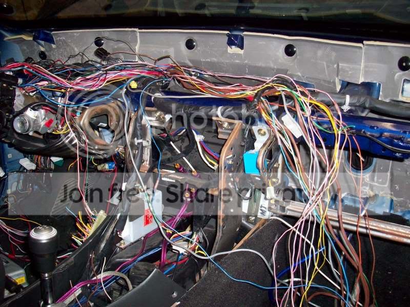

^^ That's some colorful spaghetti
Old Oct 3, 2008 | 08:20 PM
LOL not colorful enough. I still have to double check some wires on my good harness to get everything to work. (Extending half of it to get my ecu over behind the glove box)

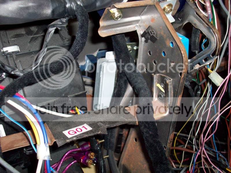

Come on, extending 70 wires isn't that bad... I mean heck, I rebuilt a 50+ pin connector on a pilot's intercomm box during preflight before a mission so that's cake right there. Nasty cake that was made with rancid milk and "special" chocolate. I recommend getting some of the little post-is tabs so you can write wire numbers on there in BIG writing, but it looks a little bit late for that...

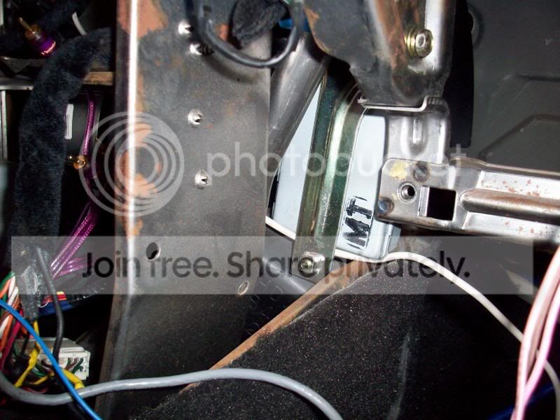

It'd be fun if that MT is a code for the shell on the box, and it's for both flavors of transaxle. nana.gif

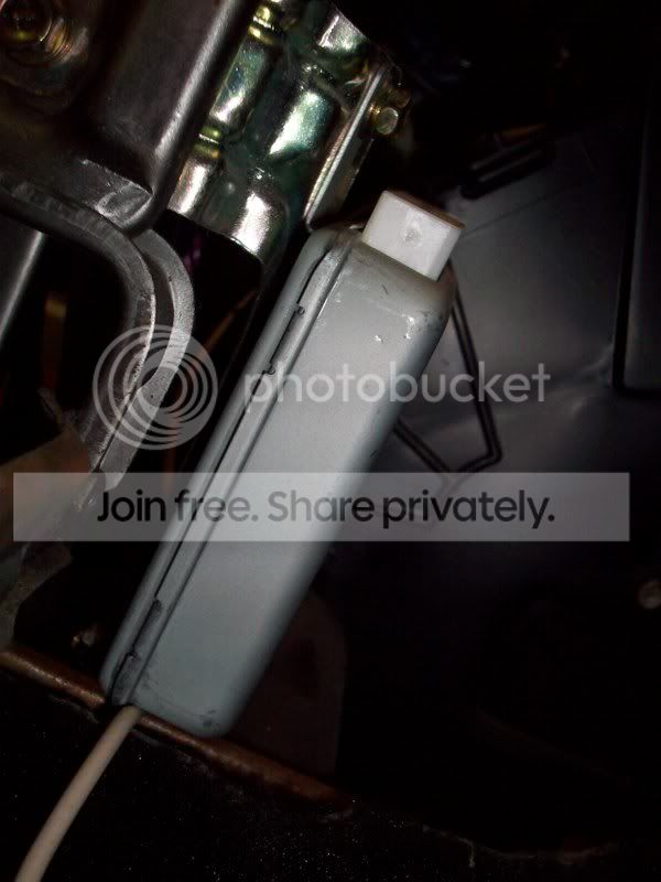

Ericy321, is there a part number on that box?
