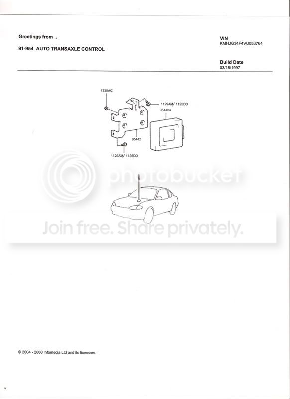

here's what they gave me. we were laughing that the picture is just a simple lame interpretation of a tiburon and an arrow, it doesn't show much!

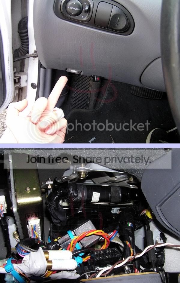

The TCM is right next to (within inches of, to the right) the ECM, on a bracket that puts it SMACK in the way of the clutch pedal being in there. You know where the clutch mounts? That's where the TCM is. Big gold box that makes the ECM hard to get out. You literally can't miss it.
here's the image I put in the 1.8L ECU knowledge thread
Dang it's crowded under my dash. The RCAs are for my garage door opener, the rest is for the alarm. That gold thing is the TCM, and if you know what the ECM connector looks like, you can tell where the ECM is relative to the TCM

yeah i don't know why the dealership diagram shows the TCM is located somewhere in the middle of the car. I did however also find a similar looking gold box with "AT" stamped on it behind the stereo din. Unplugged it and nothing happened while driving.
