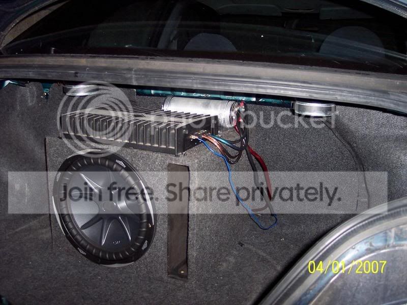

Kicker 12", ported box
Fosgate 8002a
Leather
Some pics
